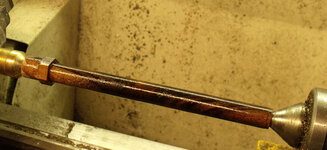

I had some free time today so I made this walnut bolt pen. It may look ok-ish, but there are several faults. But now I know better for the next one.:wink:
It has a snap cap with the nib recessed slightly into the body ( to hide it)
Unfortunately I cut the body without checking it's length and I had to leave out the spring. :redface: The external cap threads are about 12.5mm x 2mm. They did chip a little in places.
Mad at myself for not checking the measurement !! Oh well, fun anyway:biggrin: Hope you like anyway:wink:

No Bob, I used a lathe tool and even rotated the lathe by hand to get very fine cuts. Took forever!!!:rolleyes:
Here's a couple more pics. I hex'ed the blank with a router then turned to size. Then cut the threads, then cut off the threaded end and drilled the holes.
The only neat trick here was to get the exact correct size hole for the snapper was to sneak up on the hole with a boring head.
One of these is better and cheaper than a set of drill bits.:wink:

That's cool but I have a question.
Thats obviously a metal lathe, you used.
How do you keep the wood from turning the oiled ways and the oil in the cross slide/apron into mush, and not getting in the gibs and such? the last time I tried to turn anything wood on my metal lathe or mill for that matter it took so long to get everything cleaned when I was done, it wasn't worth the project.
now I keep the metal shop on one side, and the wood shop on the other and try not to let the dust into my precision machinery, (it can really play havoc with my DRO on the lathe and mill) Don't ask me how i know that. :frown:

That picture is of a metal lathe, it has a lead screw and V ways, wood lathes don't come like that, the tool holder looks like a standard indexing type also.
22 years in the Tool & Die/Mold Making Field before i retired from it. seen many a machine tool in my time.:rolleyes:

Yes, this pen was made on a metal lathe. I have a wood lathe and a home made rose engine lathe too.
I clean the lathe periodically. I don't abuse it, but it's a workhorse tool, not a precious ornament!! :biggrin::wink:
