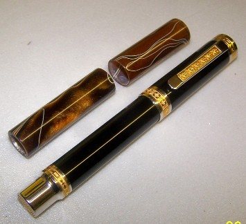

Here's a trick that could come in useful if your tube gets stuck before it's all the way in. ( Not that we would ever admit to it [8D])
Drop the blank it very hot water for about 20 seconds or so till you hear a 'click' or two.Thats the CA letting go. (I don't know if it will work on wood, but I don't see why not) Then hold the blank in a rag and use the back of the drill bit to push it out. To prove it wasn't a fluke, when I changed the blank on my B Bash Emperor, I did it again to see if I could save the finished blank.
Here's the new pen with the saved bits.
If anyone know if it works on wood, let us know
