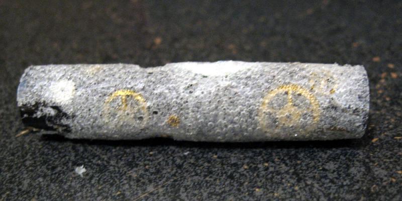

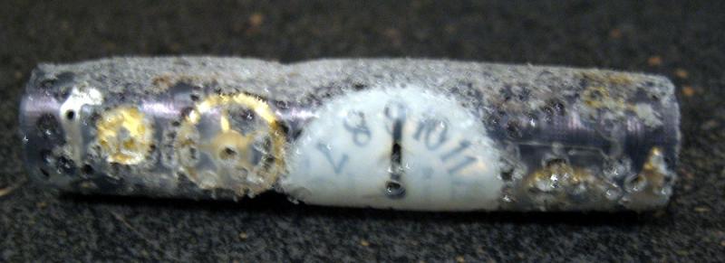

Well I have used alumilite for years making fishing lures but I guess I have previously gone through it very quickly. I spent a bunch of time taking apart watches and gluing up this blank only to use my alumilte and discover its gone bad. I poured it and it looked fine when I came back not so fine. Oh well these lessons suck but that will not happen again. by the way it looked really cool.

Isn't there some way to dissolve the alumilite off of the tube? I don't know anything about casting, but something has got to dissolve that stuff.
I had a similar issue recently and was able to dissolve the alumilite in acetone. Takes between 24-48 hours. May also dissolve some of the CA glue (assuming that is what you used) but, at least in my case, the CA held-up longer than alumilite
Ouch looks like you got some moisture in there from somewhere. Alumilite is not forgiving at all. That is why I stopped using it long ago. I use Silmar 41 with about 3-4 drops of MEKP per once and it's not too brittle. PR is a little more forgiving. But they both have there pros and cons depending what you are doing.
