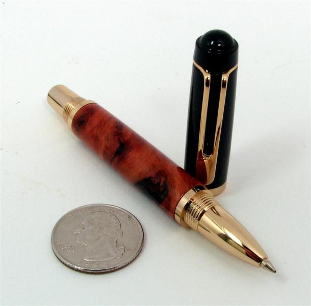

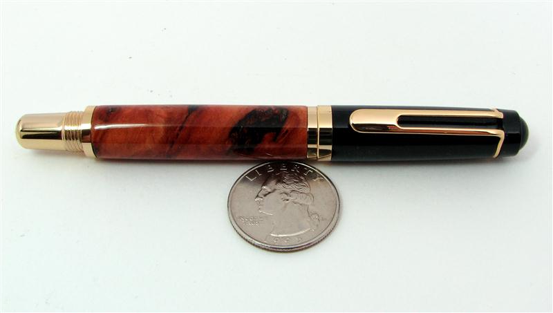

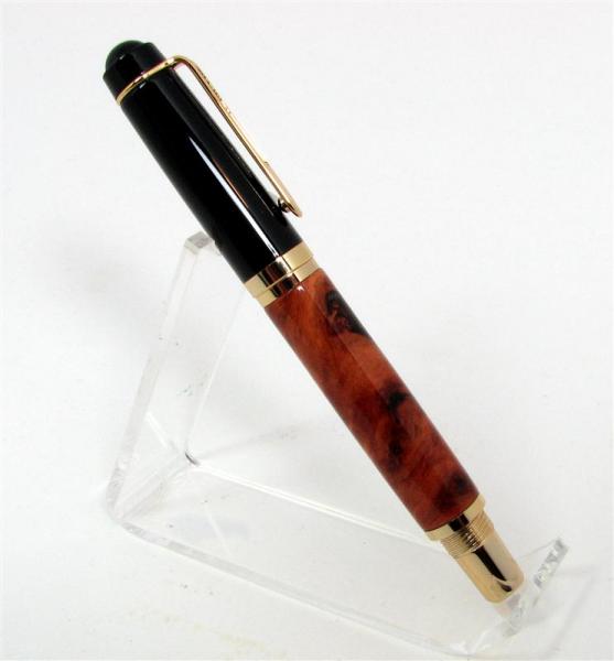

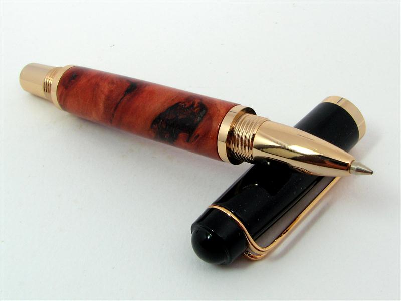

I can see that these will earn a spot in our lineup. It's small but surprisingly just the right size when posted. No fancy segmenting or anything on this one since it was a first time with the kit.
Red Gum Burl body with CA finish

Thanks.
Fit is a little tall on the writing end but just about spot-on on the finial side. I was TBC and must have missed my measurement somehow so I'll probably knock it apart and take that last .05 down just to flush it up.
I was surprised that I like the finished product of this kit as much as I do.

For an apprentice line kit from them, it's actually pretty stout. When posted, it's still shorter overall than a slimline. I can't say for sure that the ballpoint twist version is the same length, but I imagine it is. But it's a thicker pen than a slim or trim/comfort line so to my hands it's more comfortable.
I haven't done any lengthy writing sessions with it, so not sure on the fatigue factor with the shape of the tip end and I forgot to bring it to work today so I'll have to follow up on that. The only thing I can say is that they are on sale right now and grab a few of each type to try them out. I have a few Manhattan click pens lined up to turn as well to get an impression of those.
About half way through drilling I had a thought to do it as a closed end but realized that with that short length, you need the postable cap to make it long enough to write with. I may try a closed end version with a longer body and keep that kit cap.
Also they take a shorty style refill, so be prepared to offer refills to your customers since they are likely not available at the local office supply store.

Well, after writing with it on an off through the day, I have one major complaint. The sharp lip where the writing tip transitions to the pen body. There is no easing of this edge so it's very uncomfortable as your finger moves around during writing. The only solution appears to be to hold the pen 100% from the body and not down at the tip.
