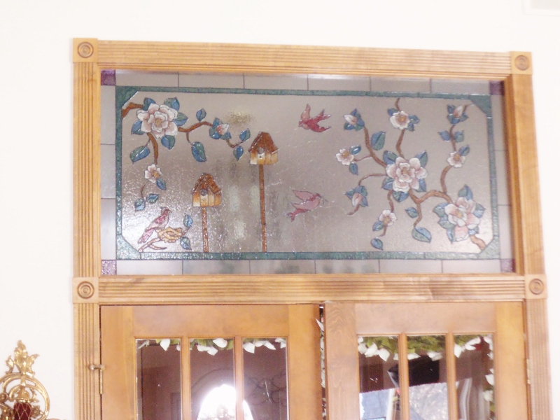

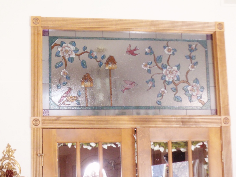

Bob; This isn't casting but it might be something you may want to look into for your woodworking projects. The panel in the photo is a piece of plate glass over my french doors. It is about 3 X 6 feet. I used a product called Gallery Glass, made by Plaid Enterprizes. It's a translucent paint that looks and feels like stained glass. Easy to apply and can be swirlled or blended in any color or pattern you want. Nice thing is if you get tired of it, you can peal it off, reuse it someplace else, or start over. I have used this for glass cabinet doors in kitchens and gun cabinets, holiday decorrations in mirrors, and to make stained glass panels in windows. Can usualy be found in Hobby Lobby, Michale's, or any hobby or craft shop. Just an idea !! Jim S
