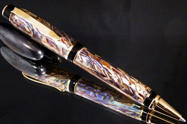

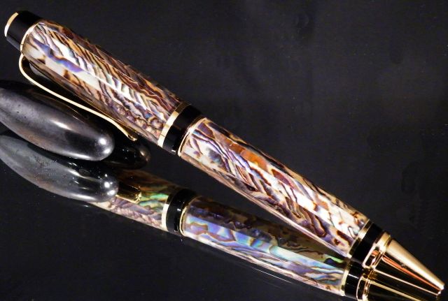

This is a Paua shell cigar I made for my MIL . She has been a great help during this bout with unemployment and I wanted to do something nice for her so I picked out some exceptional shell to create this pen . The colors in this shell stock are spectacular , too bad I can't get it to show in the pictures . She suffers from arthritis and she needs a bigger pen so a cigar pen is perfect . I just hope she likes it .
As always , comments are welcome .

Fantastic pen. Just look at the color differentiation from the top of the pen to the reflection on the bottom, the colors must slap you silly. I am sure she will love it.
Butch very nice looking pen, where do you get the paua shells? are they veneer sheets?
Thanks for the kind words everyone . These shell pens have become my most requested pens now . I can't keep the sierras in stock , everyone that sees them wants one . The biggest problem is that they take so much work to make . After I cut the strips they are each hand sanded to get a clean , tight fit . Then the strips are glued to the tubes and sealed and the tubes are sanded and then cast . Even after all that work I still get about 10% failure due to separation between the shells and resin . That's why the ones I sell here are turned round and polished so I can inspect them for problems .
Louie , I get my stock from a jewelry supplier in Australia , but there are a number of places on the net where they are available . There was a thread about a week ago on suppliers . I think it's in the casting forum .
Paul , yes I do occasionally make kit pens .
Cris , the color that you see in the photos are just a tease compared to what they look like in person . The base color is a shiny silver that shifts to blue and gold and even purple when looked at from different angles . Under a bright light or sunlight the pen really comes alive with color , it's amazing .
Butch didnt know Jersey had such beautiful shells:biggrin:Great looking pen MIL is going to love it!! Cant wait to see what else you are up to:eek:
