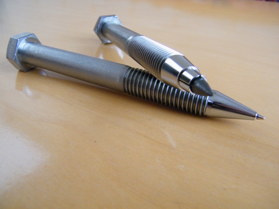

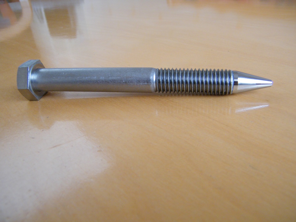

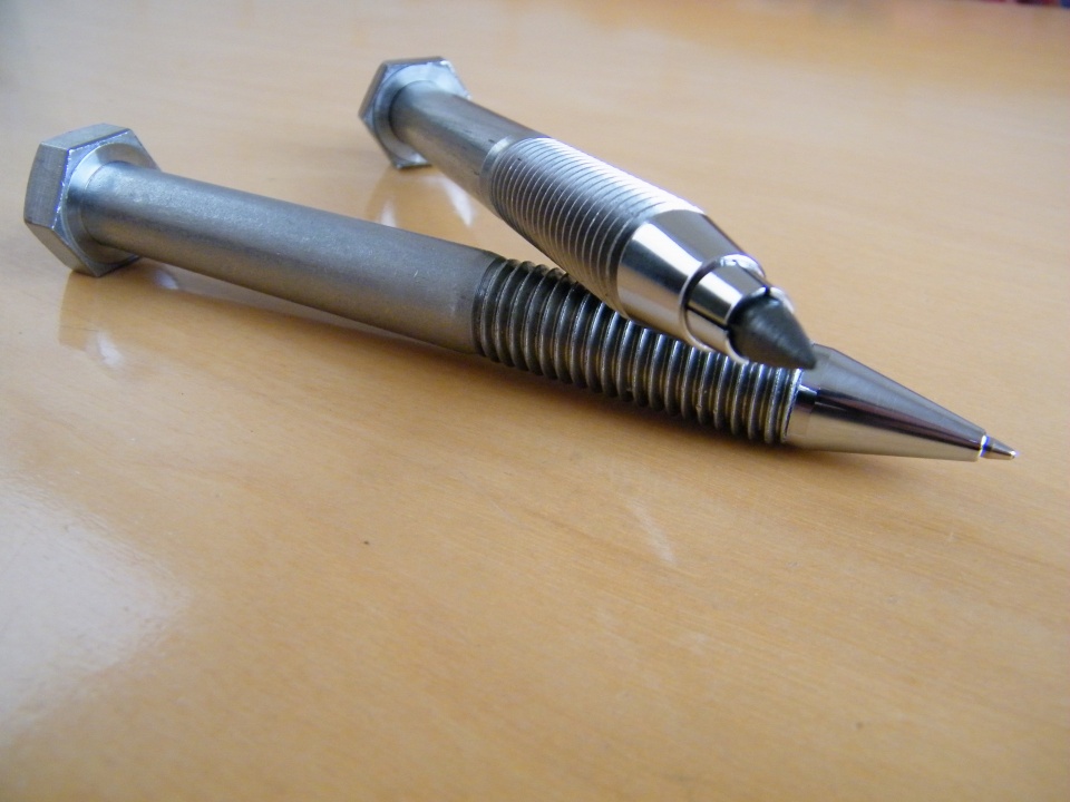

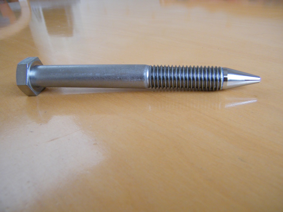

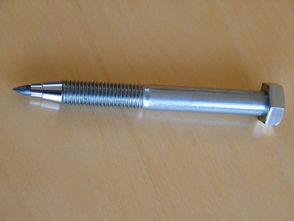

Hi. Made my eldest a pen and toolbox pencil from a couple of stainless steel bolts back last December. The bolt head of the pen turns to operate the mechanism and the bolt head of the pencil pushes down over the bolt body to open the pencil clutch jaws. He is an engineer - hence the bolts!

Many thanks for the "cool" comments - much appreciated! My son confirms that he also considers them to be cool, and he uses them which really makes me happy! I don't think that there is a much sadder thing than spending time to make pens that then sit in drawers.

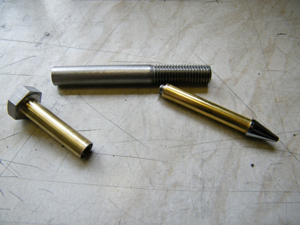

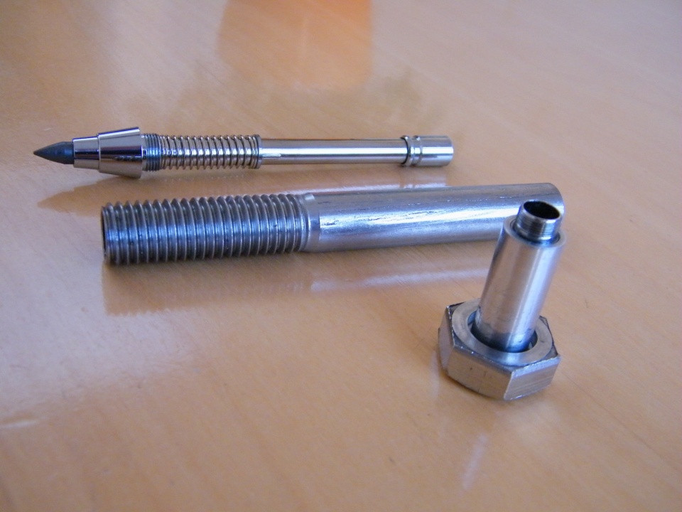

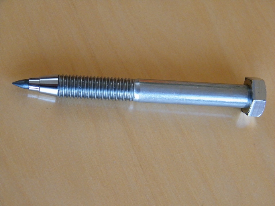

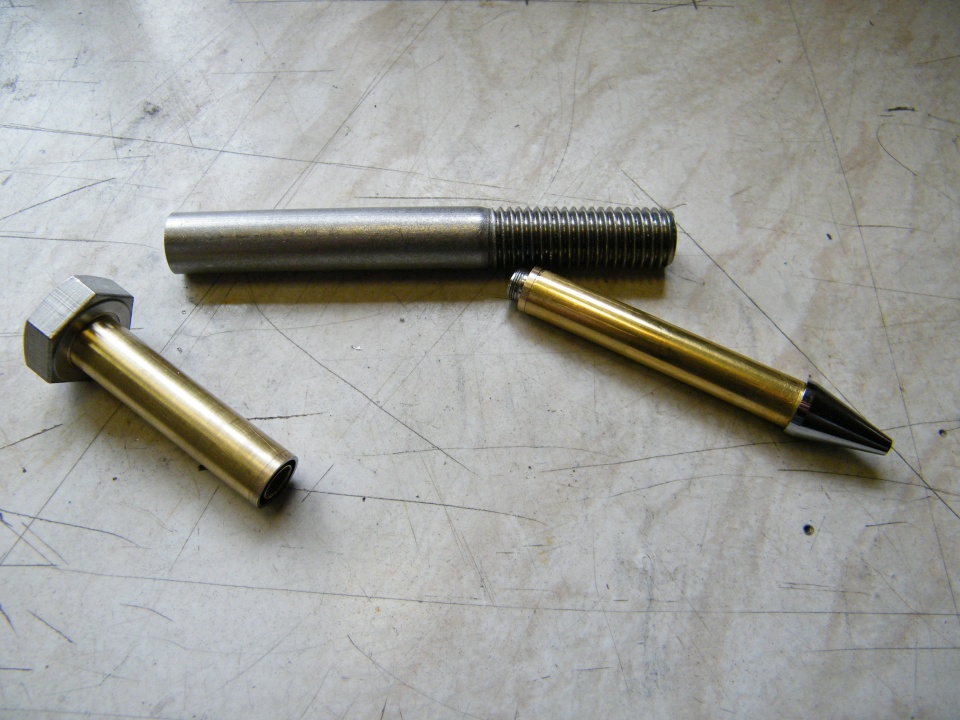

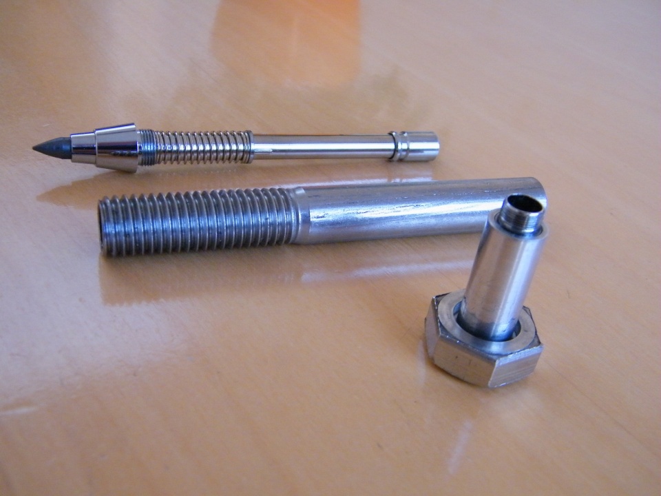

I have attached four more images (thanks for asking Curly!) - two of which show detail of how they were made up. The pencil is a standard toolbox / artists pencil mechanism. The sharpener is fitted into an extension from the bolt head so that it can be screwed onto the mechanism and then pushed down to operate the pencil jaws. The pen is based on a Berea Atrax mechanism and tubes with the lower tube glued into the bolt. I'm using the same principle to make two differently themed items for my youngest (who is also an engineer and got me started on pen making). I'll post pictures once these are finished.

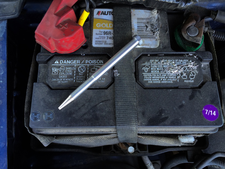

Instead of fighting another hardened bolt on the lathe I just made a bolt from aluminum round and hex bar. Thanks again.

Thanks Danny. I am glad that you liked the post. As jttheclockman indicates, the idea for making a pen from a bolt originates with SkipRat - I just added the twist of using a pen mechanism and also making a matching pencil. As for using real measurements rather than metric - it's getting harder over here to find to find them now! Glad your Dad enjoyed his pen - my son does too (for very similar reasons).

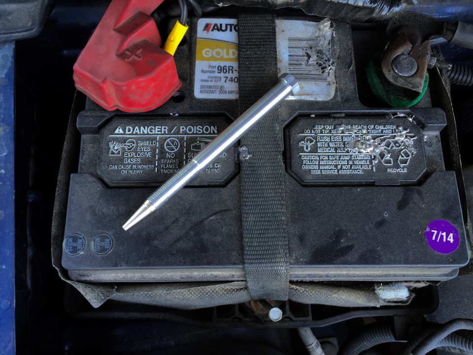

Here is the aluminum one.
