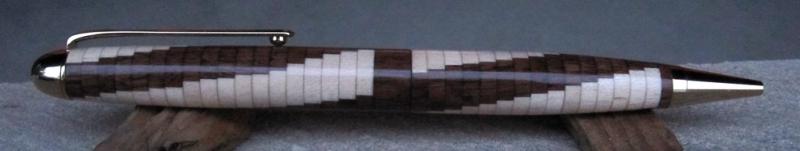

Here is my first segmentation to make it to a pen (the first drilled way off center and shattered on the barrel trimmer.)
Walnut and Maple on a PKMONT kit.
I was worried to death while drilling it. I wasn't afraid this one would shatter - worried I would be off center.
132 peices in the spiral sections, plus 2 bands - 134 peices total.
I really need to learn to take better pictures too.

Nice work, you nailed it! I like the colors also.
You can also build these by pre drilling the blanks, cut your slices,
and gluing up the pieces on the tube if you are worried about drilling.

Yes, I am considering that. I'll have to think up a new alignment jig ... and a way to drill square blanks. Hmmm - the tube would keep it straight, but complicates glue up - I'll have to ponder on this a bit :smile:
It doesn't show in the photo, but the bottom tube is slightly off center. Just enough to see - if you look for it.
Fantastic job Dennis . That pen is awesome . Get yourself a collet chuck and drill on the lathe and you won't have to worry about drilling true center . Also with a collet chuck you can throw away the barrel trimmer and true up the ends with a skew , it much less likely to catch and destroy a blank . Once you get a collet chuck you will wonder how you ever did without it , they are a little expensive but worth every penny .
