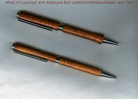

I'm a fountain pen collector. I have a wide variety of ages (new to nearly 100 years old) in a variety of styles (stubby cigar types to long presentation pens) and compositions(wood to acrylic to glass). My favorites seem to be the older wooden variety. They have a feel that I just don't find in most of today's pens.
So, I went back to basics to see if I could replicate that feel. One of the things I'm trying is to sand tooling marks and sanding swirls off without removing all traces of the grain and texture. In short, I've been heading back to the future. My results have been mixed, as I'm not the finest craftsman you ever met, but I'm starting to produce some pens that have that same warm, wood feel. Part of it may be the TSW, but more and more I'm working with my sanding techniques.
I've stopped sanding the same piece of wood 13 times in order to get a smooth-as-glass feel. I now sand with the lathe on for my 220, then I sand with-the-grain (lathe off, of course) and follow another with-the-grain sanding at 320. Finally I turn the lathe back on for MM1500, then turn the lather off for a final with-the-grain sanding with the MM1500. What I'm getting as a final result is a pen that is free from tool marks and sanding swirls, yet still feels like real wood. I finish, typically, with sanding sealer to close the pores and grain, and follow up with two coats of TSW-1121, hand buffed to a satin finish (my personal favorite). To be sure, there are some flaws, but that's part of what I like about wood...the beauty of its imperfections.
I've been working this method on slimlines first (because they are quicker to turn and less expensive to test with). Here are two of them. I'll probably try a cigar or Gent Jr this week.

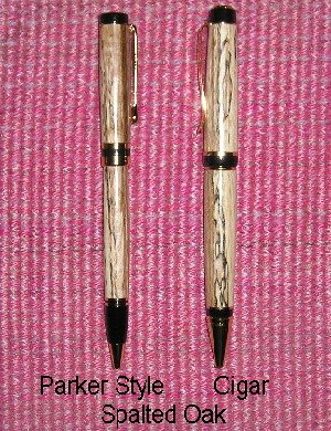

Thanks Fred....Actually the wood is from an Oak board that I had bought for face frames and door frames for my bathroom cabinets. As I was looking through the boards finding those that were straight, I found this one with spalting on one end and thought, that might make some nice pens. That is the result you see in the picture.
Rod,
Very nice pens! And I agree, not boring. But even boring pens seem to sell will to some customers, and I think it's just that they recognize the name of the wood.
