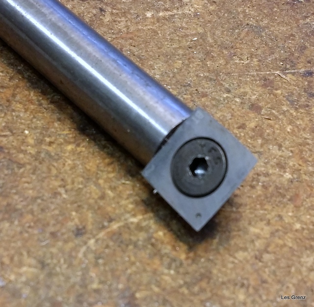

Thanks to IAP member Larryc I have 80 new to me turning tools. Larry presented me with 80 used 15mm square inserts. They are used but work well turning wood and plastic. I made a insert holder today and tried one without sharpening and it worked great. I still need to make a handle for it but tried it just holding the steel rod. Thanks Larry.

That is awesome. My first thought was how did you make the tool holder, but then I remembered you do metal lathe work as well as wood lathe work. Great deal for you! I have only used a round Rockler carbide so far, but was eyeballing the Capt Eddie, but well that is on hold until he gets back into the shop. :)

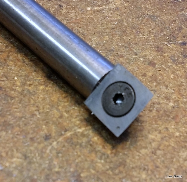

I made a set of carbide tool handles from a set of Harbor Freight pry bars.
Pry Bar Set - 4 Piece
I cut off the bent end and ground a flat for the cutter, and tapped it for a screw. Four tools for about three dollars apiece. I've been using them for several years now. One of the plastic handles eventually came off and I replaced it with a turned ash handle.

What do you need to tap that hole for the screw on those - is that typically a standard size?

Here is a picture of the tools. I left a bit of the bend in one to make a hollowing tool. Included is a picture of one of the pry bars before modification.
Sharon what size did you make the threads in your pry bars for the global tool cutter screws? are they 10-24 too? like Capt Eddies
