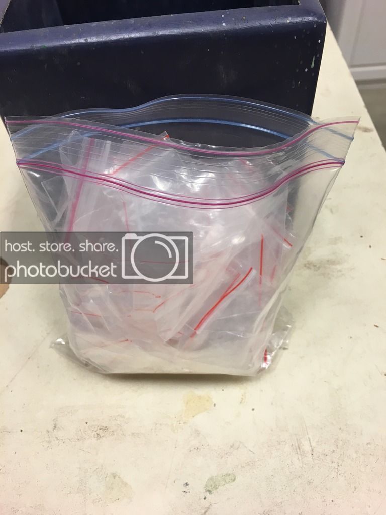

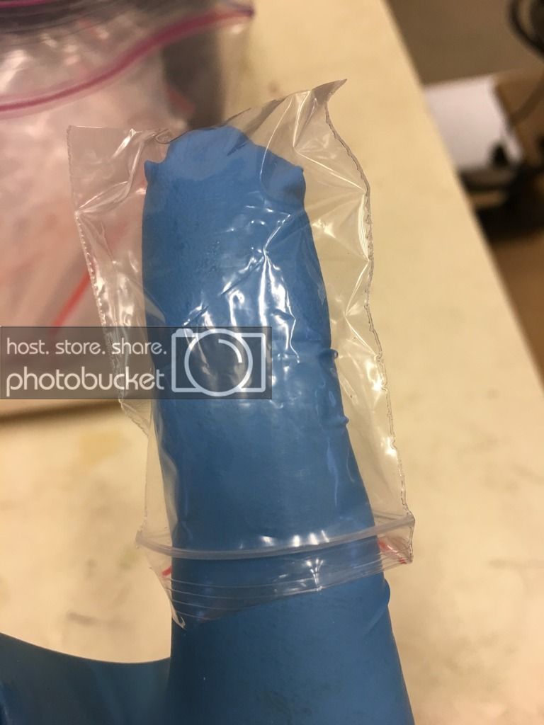

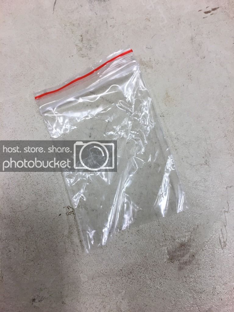

I have tried blue towels and craft foam, but my new goto method uses the plastic bags from pen kits. I still use gloves to prevent stuck fingers and burns from CA glue.

I remember years ago people asking what they do with all those plastic bags from kit parts and someone suggested back then what you are doing. It caught on for awhile. I like to use the fingers of the nitrile gloves. Cut the fingers off and you have 5 applicators right away. Many ways to get it done. :smile:
Luckily all bags for subcomponents in my pen kits are free of any writing. I change "bags" after each application of CA.
