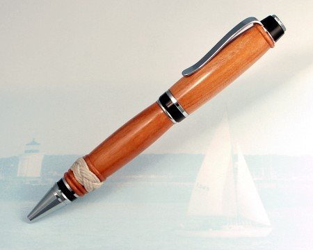

I had a customer request a "nautical" pen that he could keep on his sailboat (a nice 36-foot Beneteau cruiser). He wanted something fairly large, since he has trouble holding slim pens, and was interested in teak.
After visiting his boat, and seeing that all his interior woodwork was cherry, not teak, I came up with this:
I have some misgivings about it really being "nautical". I believe the cherry and chrome will accent the boat's fittings nicely, and the turk's head knot is quite grippy, but is that really enough? Short of inlaying the Beneteau logo, or other sailing image, what else could I do?

nice touch with the knot, im not sure as well if it looks nautical enough.
I have seen a pen somewhere that was made to resemble a belaying pin.
http://www.woodenboatfittings.com.au/pins.htm
just food for thought
pete
I wouldn't lazer anything in it to ruin it!
Have you considered adding another ropey thingy to the top secton underneath the clip?
You can also turn down the black PC brass CB and add the ropey thingy there.Leave part of it to act as a "Stop"
That black piece is not necessary once the pen is assembled otehr than to guide the tranny in.The refill can be changed out from the nib end.If the PC black piece is ommitted the upper tube needs to be lengthened.

My apologies, Eric! I like the pen as it is. Laser engraving is a personal preference, but I don't really think it needs it.

As regards, the pen, I like the subtleness of the nautical reference...and by incorporating the cherry of his interior, I think you've got a hit!

Lol, yes, the "Belaying Pen" http://www.penturners.org/forum/topic.asp?TOPIC_ID=17315&SearchTerms=belaying,pen is one of mine. Unfortunately in this case, it was too slim for the customer. His "easy to hold" requirement led me to put the knot and the beads down at the nib. The bead at the finial is just for continuity. My original concept had single beads on each side of the centerband also. When I saw the shape taking form, however, I felt it looked too traditional and turned them off.
I'm thinking of recreating the Belaying Pen using a cigar pen kit rather than a slimline. I haven't quite decided yet how much of the hardware to leave off. I expect I'll either turn down, omit, or counterbore the centerband entirely on that one.

I think it looks great as it is, but that doesn't mean I don't agree with Eagle's "ropey thingy" idea. That could be a very nice touch. But, you don't really need to do anything else to it.

Yes, I think Eagle has an interesting idea, especially about replacing the centerband. If so, I might choose a different knot, so "ropey thingy" could be an accurate description at this point.
I did consider adding another knot at the finial, but felt two turk's heads would make the pen too busy. My normal inclination would be to put the decoration at the finial end (especially given the shape of a cigar pen clip), but in this instance, I wanted it to be part of the grip.
Hmmm, maybe I should make a version with the Beneteau logo engraved - just so I can show it to the factory rep next time I see him, lol.

IMHO, the ropey thingy instantly gives the pen an unmistakable nautical air. It's also functional and looks very cool. I'll bet some of your friend's crew or fellow sailors have bracelets made in the same way (long a pastime on the midwatch). I would not mess with it further, it looks great!

Nice work. Having done quite a few turks head knots over the years, it looks very nice. My only concern would be having it part of the grip might cause it to get grungy and start to show wear after a while. Placed under the clip at the finial would help eliminate this problem.

Well, the entire knot is sealed with CA glue, so I expect it to hold up. Otherwise, yes, it would get grimy fast. I one used waxed whipping twine without thoroughly washing my hands first. That turk's head was dirty before I finished tying it, lol.

#8 whipping twine, which is made of Dacron. I tried #4 in the past, but it was too small. After snugging the turk's head down securely and burying the ends, I carefully saturated it with thin CA. I don't think that knot will go anywhere without the rest of the pen (or at least the lower blank).

I've seen a weathered-look type of small stuff that was silvery grey in color. Might obviate the discoloration problem.
Or just do what the bosun's mates always do... PAINT IT![;)]
cheers Eileen [8D]
Personal opinion, but I'm thinking the Rope Band might look better at the top... Doesn't look Comfortable to me where it's at. Either way, it really is a great looking pen.
If you're concerned about it discoloring or fading, get some Color Preserver made by Gudebrod. This is commonly used by rod builders so the thread wraps don't fade.

I like the idea of the a TH for a centerband and agree that a knot and laser image would be too much.
If your client can afford a boat like that, he can probably afford two pens. Why not a set...one lasered and one knot??
