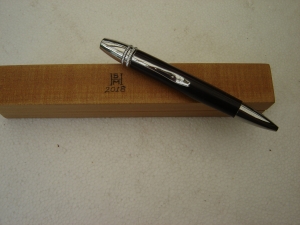

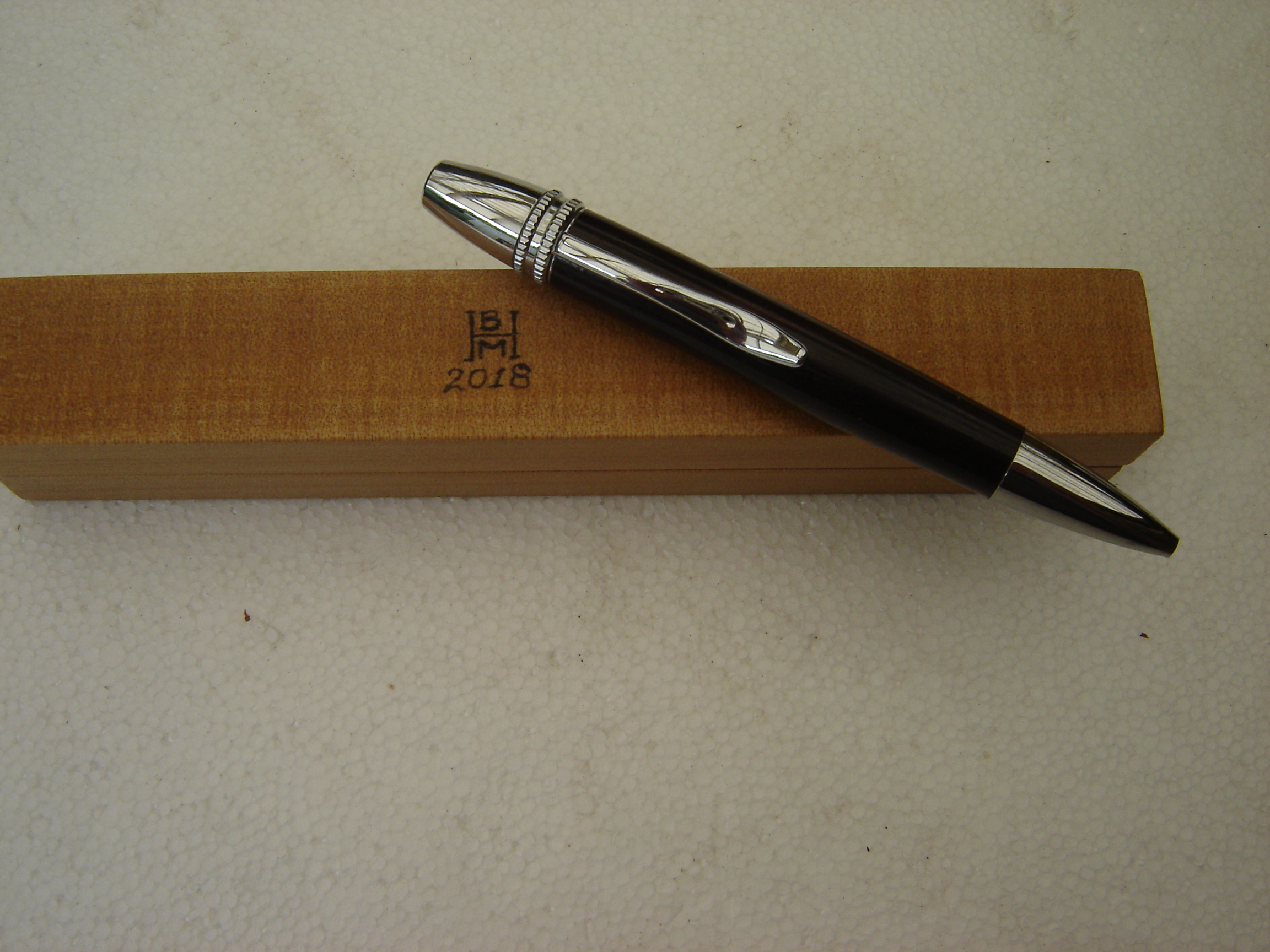

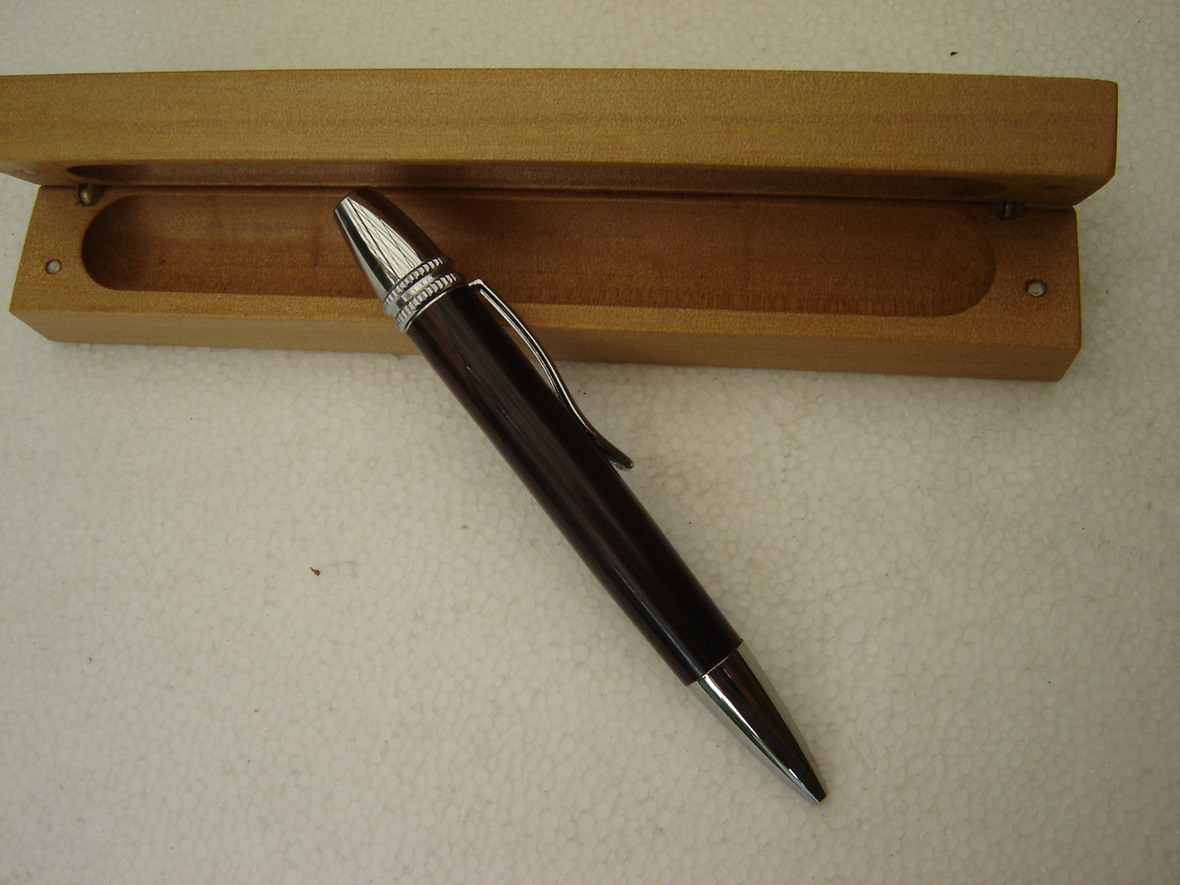

A Chrome, Polaris Pen, with Southeast Asian Ebony, for the Kind Gentleman who gave it to me several years ago.
The piece of Ebony had been in an earlier life, a leg off an Plant Stand,
Unfortunately there was only one, and I found when turning this Pen that the Leg had been repaired and a piece of some other (red) wood, had been glued, and Stained so it looked like it was sound.
That was until I started to Turn it, and pieces started to come off, with a rather course grain, not at all like the Ebony.
But the Good Gods of Recycle were looking after me, as I ended up turning off, most, if not all of the additional wood.
Finished with Micro Mesh to 12000, three Coats of CA, and Micro Mesh after each coat.
Finally given a coat of Renaissance Wax
