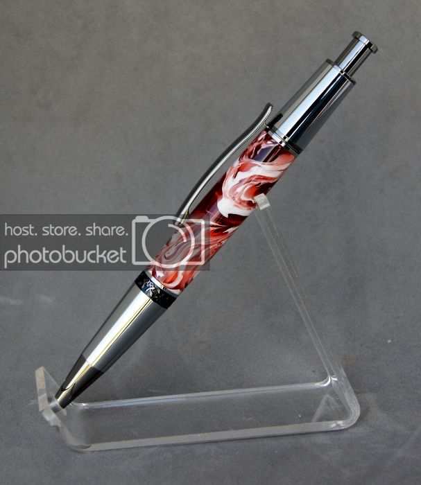

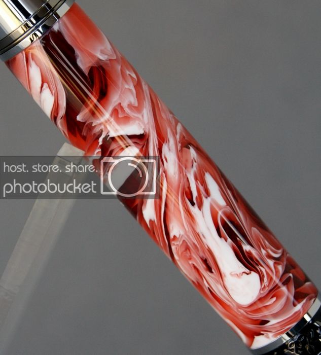

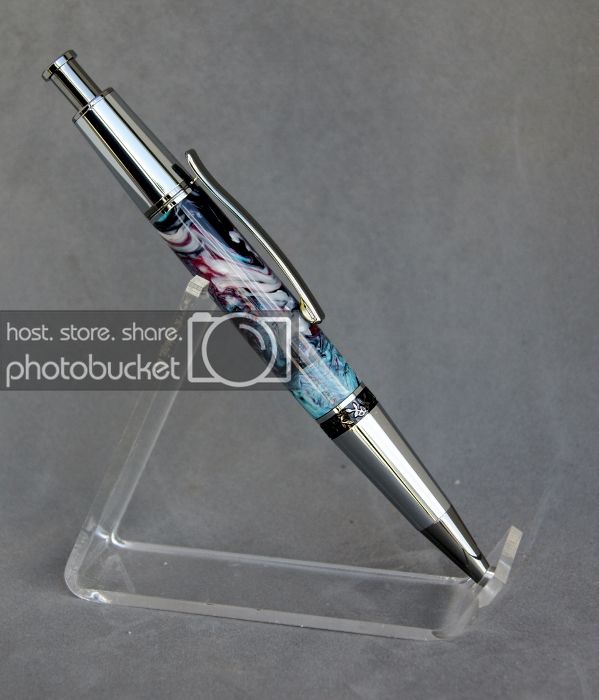

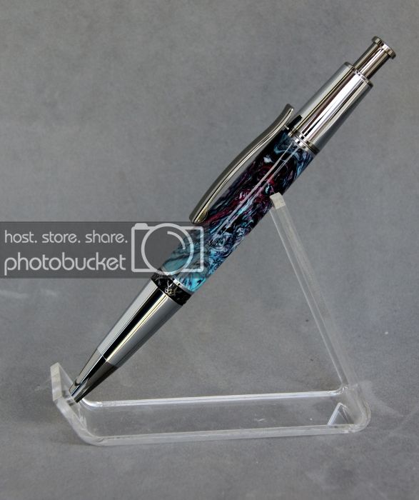

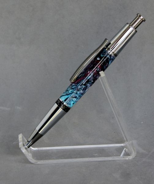

Now that I finally got that large order done I used a bit of "free" time today to turn a few pens to be sent out on consignment. I've got a few more I want to make to go along with these but I've got to get them prepped first. I hope you enjoy these! I used Chrome/Blk Ti Aero Click pens for all of them. I really like these! I think they'll be a big hit with those in the medical profession.

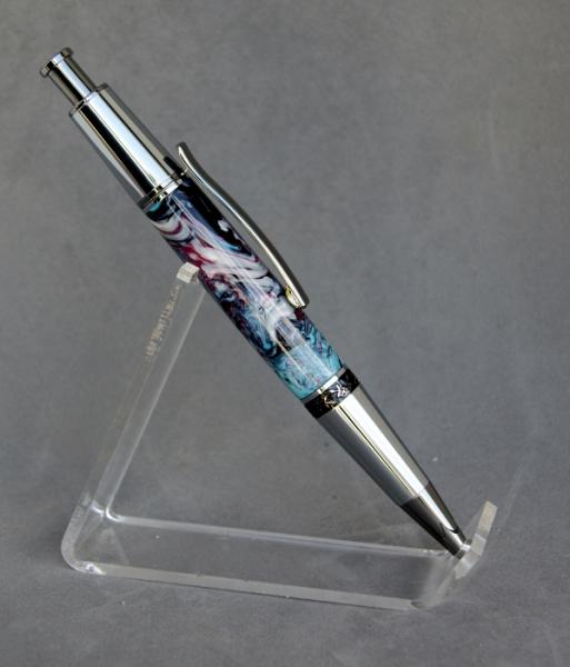

First up was made with a cast of leftover resin from a few different batches. It has Black,White,Turquoise, and a touch of Hot Pink.

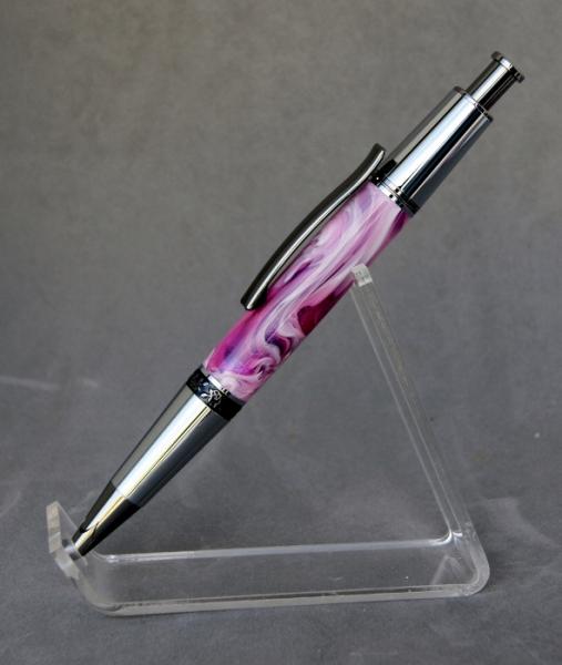

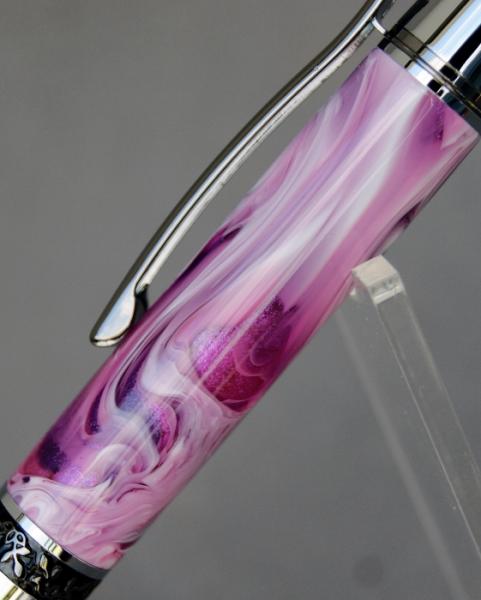

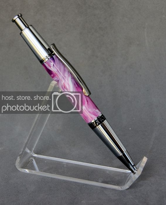

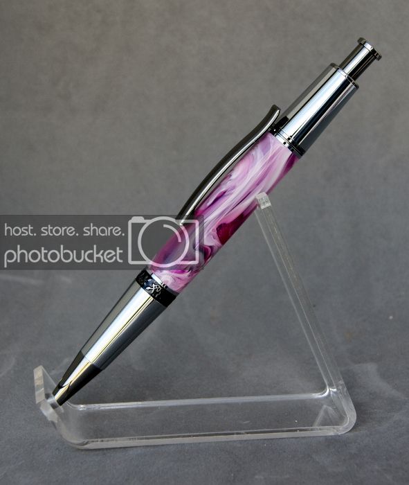

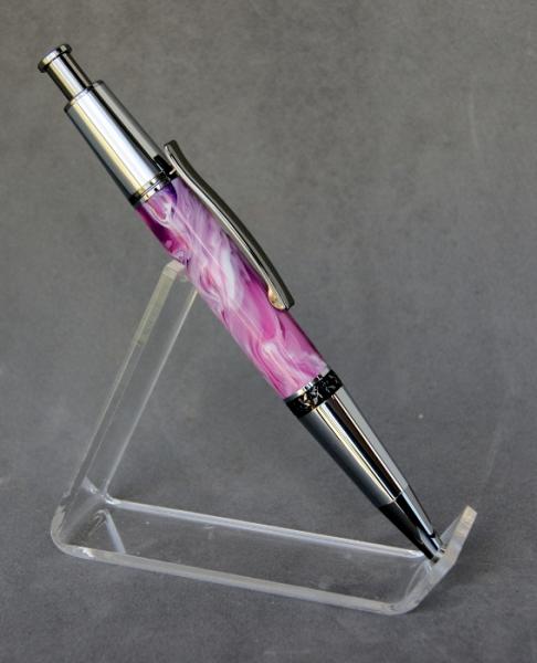

Second is one made with a mix of Vintage Purple & Pink. I first reverse painted with a bright metallic purple for the 1st coat followed by 1 coat of black to be certain the brass wouldn't show. You can see the metallic paint best in the closeup:
DSC03044 (567x700).jpg DSC03049 (591x700) (591x700).jpg DSC03048 (561x700).jpg

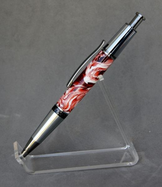

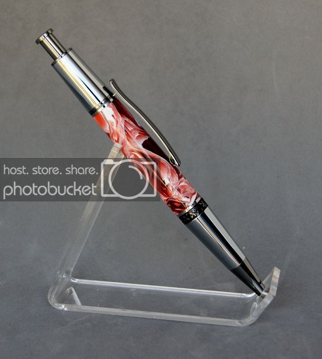

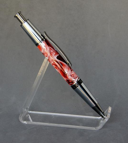

Third and last is one done with a Vintage Crimson blank. Reverse painted first with a nice medium red followed by a coat of black. I'm having reservations about letting this one go! It came out perfect (IMO):

Amazing pens Jon. Once I finish my order I'm doing now ill probably buy some of those kits.

Also I like that red one a lot. But that pink and purple really showcases how painting can change it.
Your work really is amazing, Jonathan. You start off with your beautiful blanks, and do them proud with your paint job, fit, and finish. I'm glad you found the IAP, as pens appear to be what you were meant to do.
Those are beauties for sure. I think I like the 1st one the best. How do you like the Aero click pen? I might have to give those a try. I do like the size of the aero for a pocket pen.
Beautiful pens! The blanks are amazing!

On the purple you mentioned you painted with the metallic paint followed by a coat of black. If you put black on top of the metallic why is the metallic showing through. Shouldn't we see more black than metallic? That confused me.
Thanks Bob! I really like it. It feels like the same click mech in the long click kits.

Are you brush painting inside, or spraying? As the inside painting looks super smooth!
Thanks Phil! I use an artists brush to do my painting. Another step I do is use a soft wire brush to clean out any dust on the inside just after drilling.
Thanks! You have to remember that I'm painting the INSIDE of the blank. So the first color used will be the color shown through the blank. The black will be underneath that. Hope that clears it up better.
