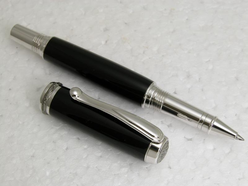

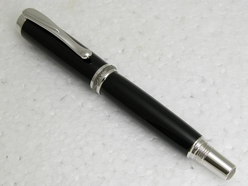

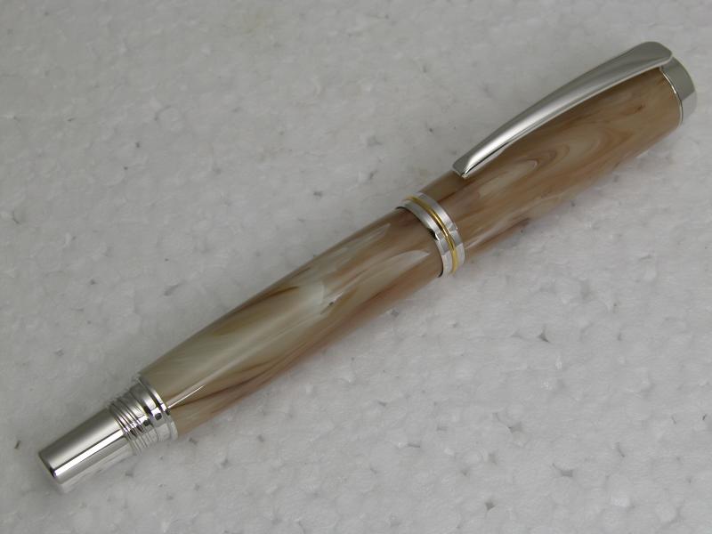

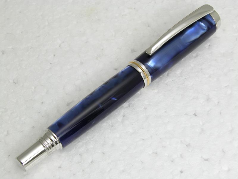

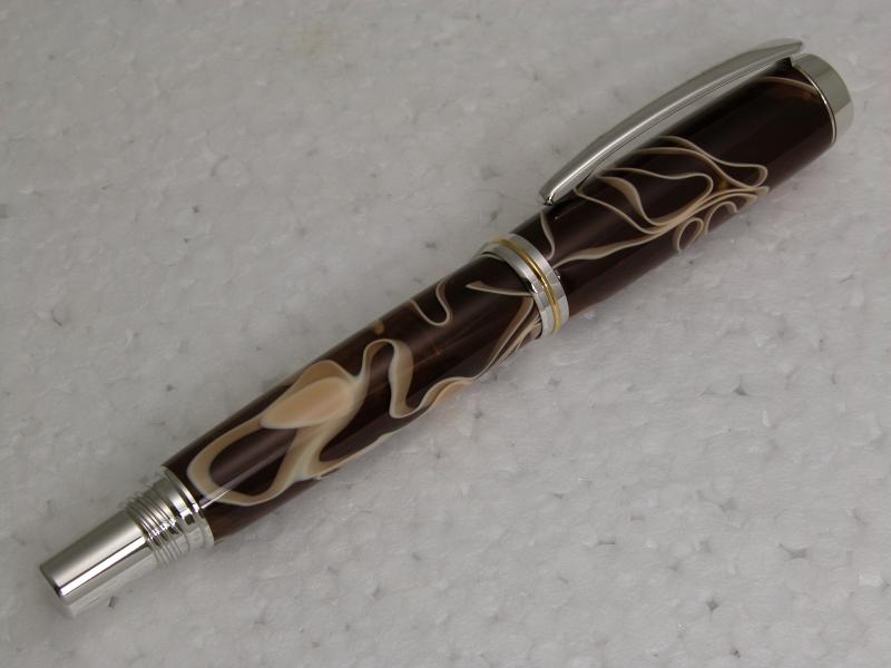

Bought a number of different lucite blanks from Ed and Dawn and just started turning a few of them. I would recomend painting the inside of the blanks after drilling them as not to see the glue or tubes. Different paint colors on the same type of blank can really vary the outcome.
The first is the rootbeer float on a Jr. Gent I painted the inside of barrel a darker brown color.
Second is the black lucite on a Jr. Statesmen, painted just black inside of barrel.
Third is the Kahlua and Cream on a Jr. Gent, painted tan color inside of barrel.
Fourth is a Sapphire Blue on a Jr. Gent, painted bright blue inside of barrel.

Keith, Those are a set of beautiful pens ! Favorite is definitely the root beer float. The swirls seem a lot more pronounced by painting with the darker brown color. What brand of paints do you use? Do they come in a set like Testors? Great job! Thanks for sharing. Regards, Doc

The root beer one looks much richer with the brown paint. I used white and it washed the colors a bit, but offered a nice look. These look awesome!
