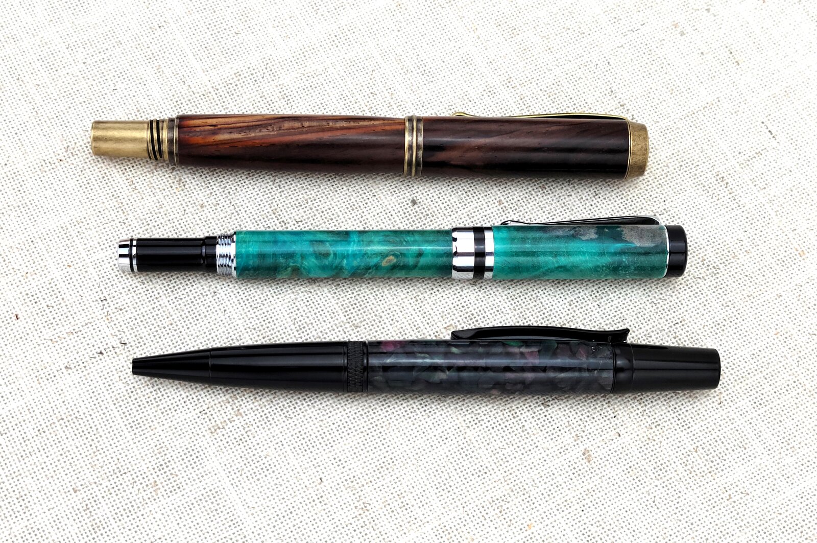

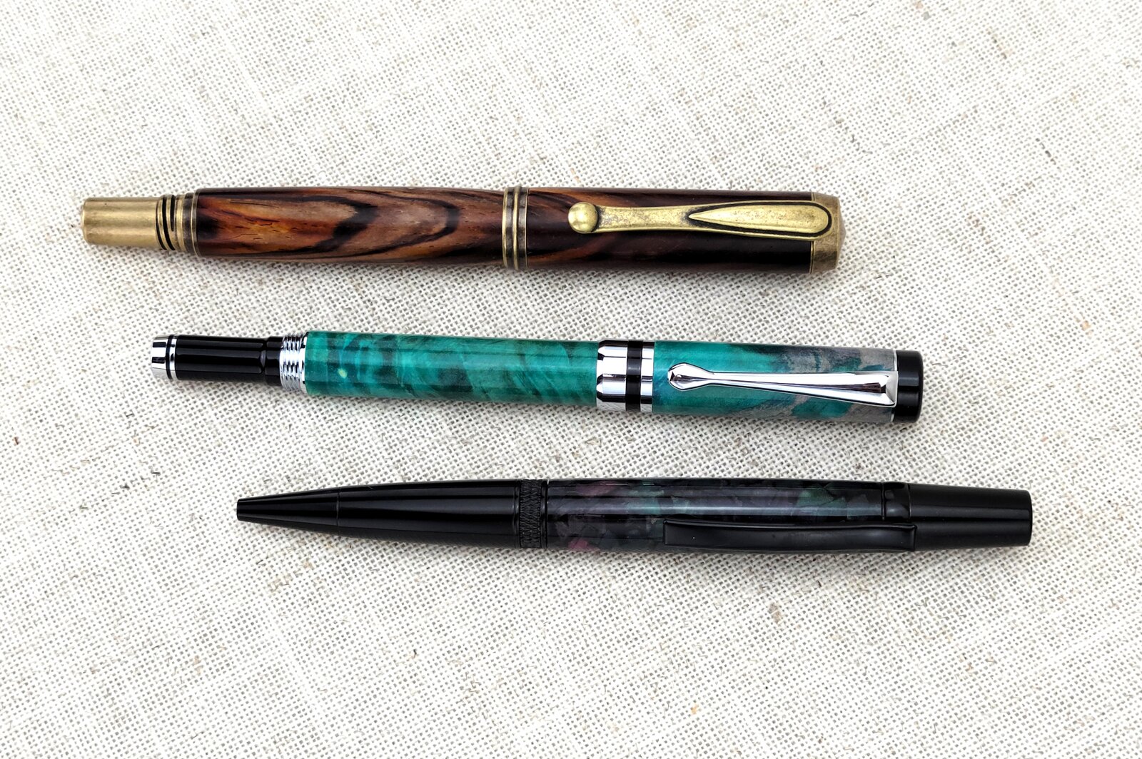

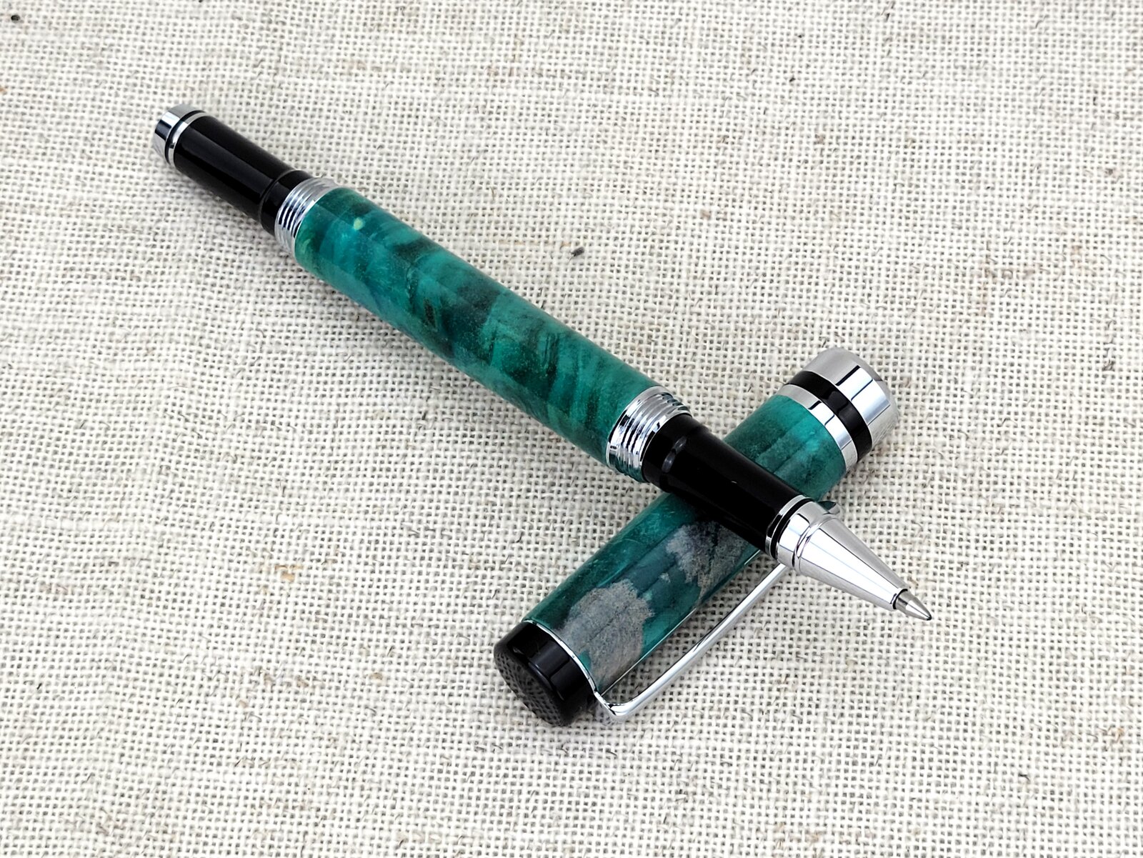

I have had pens in various states for a while, some blanks cut, some drilled and glued, some squared and ready to go... anyway, I finally got to a few of them. It's an interesting variety. The pictures are definitely not my best work. There's probably still a dozen squared and ready for me get around to them.

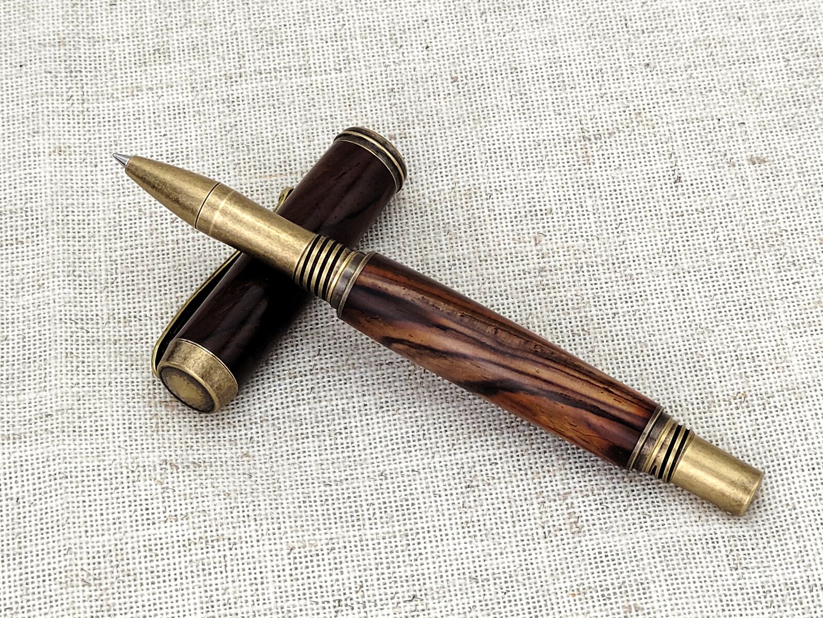

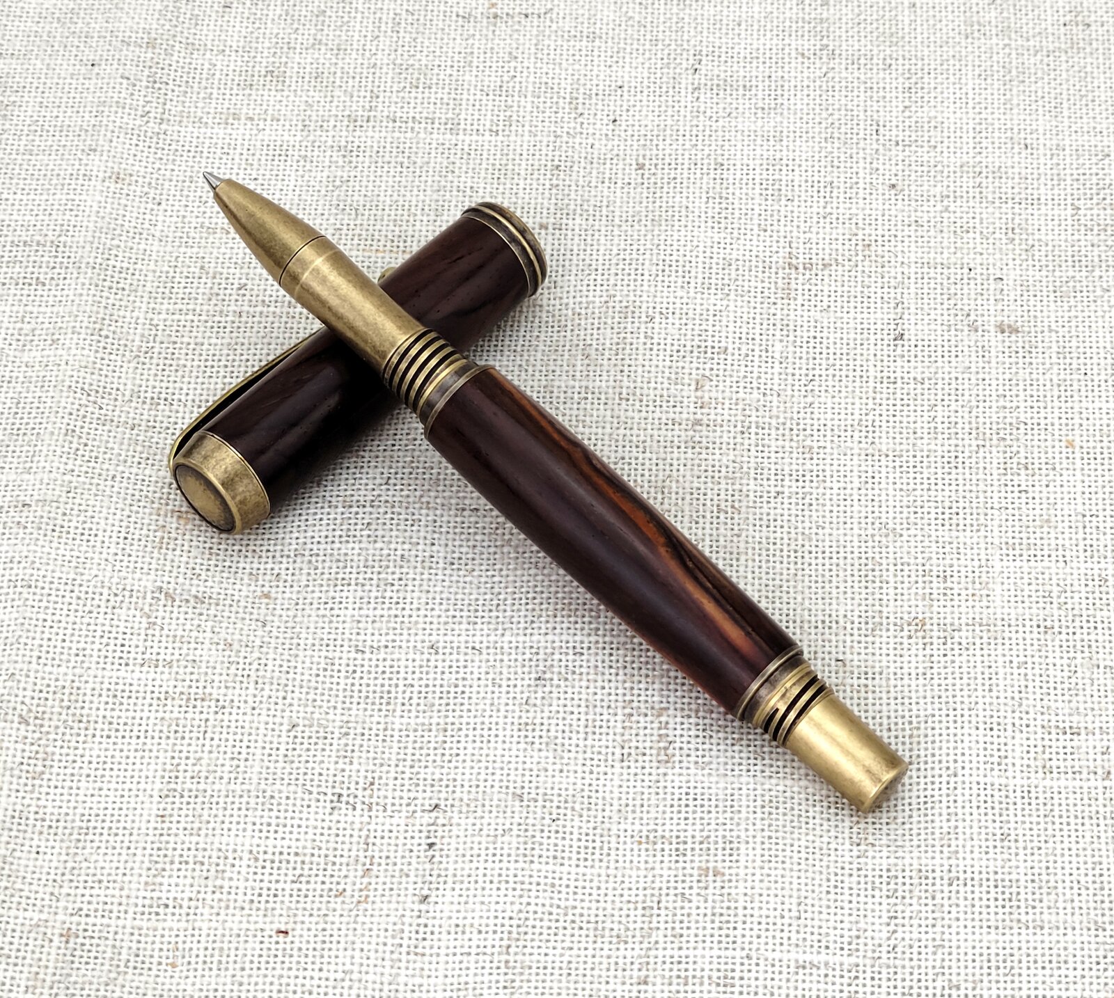

Jr. George in cocoblo, gluboost polished to a somewhat matte finish. (I used some acetone to remove some oil and allow the CA should stick.)

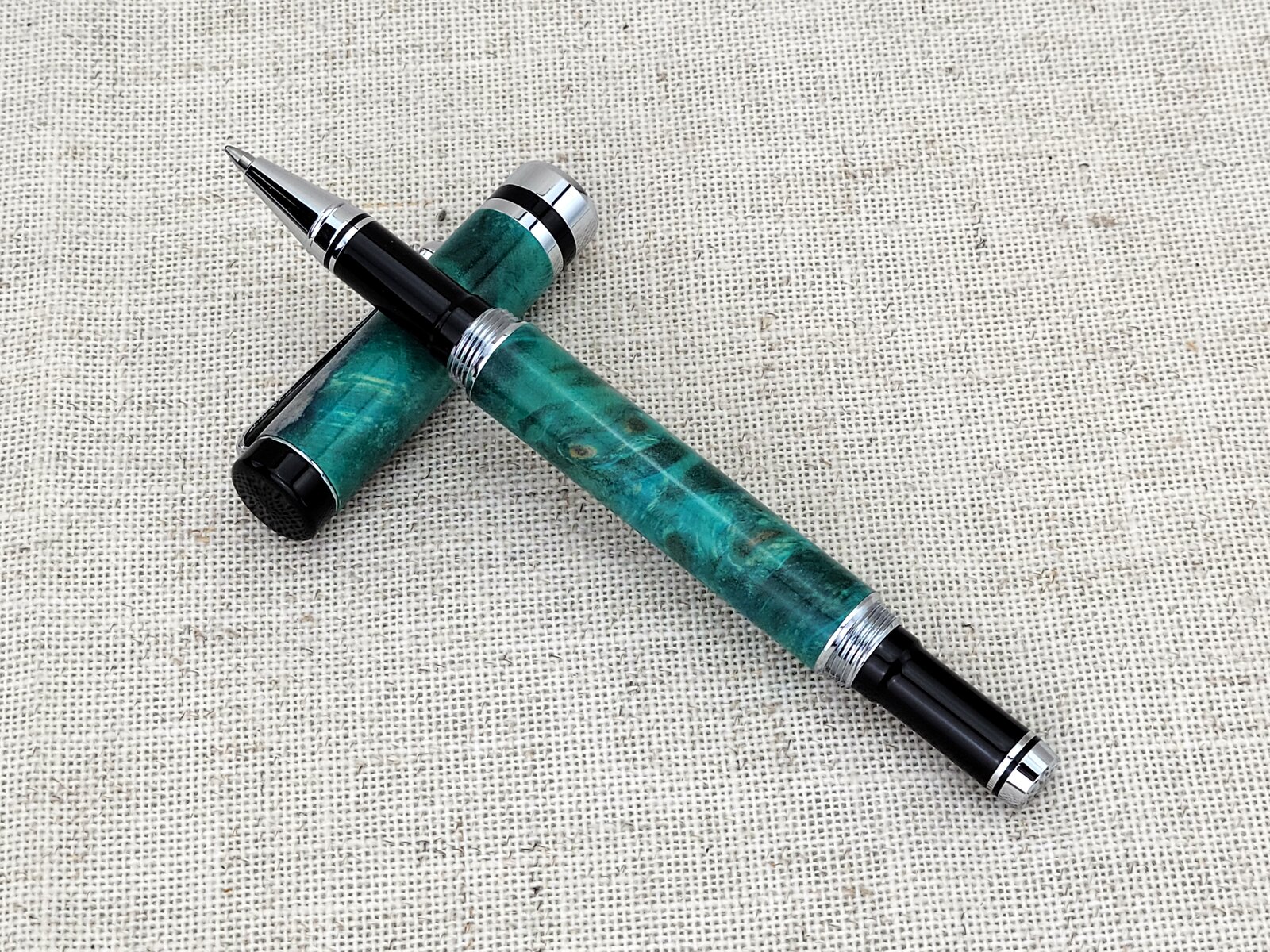

PSI classic rollerball with a dyed maple burl blank. This is also gluboost, but polished through all the zona grits and then some Maguire's scratch plastic polish. (I'm planning to gift this to Dallas Jenkins for the big premiere of The Chosen, season 3 this month. Great show for those interested!)

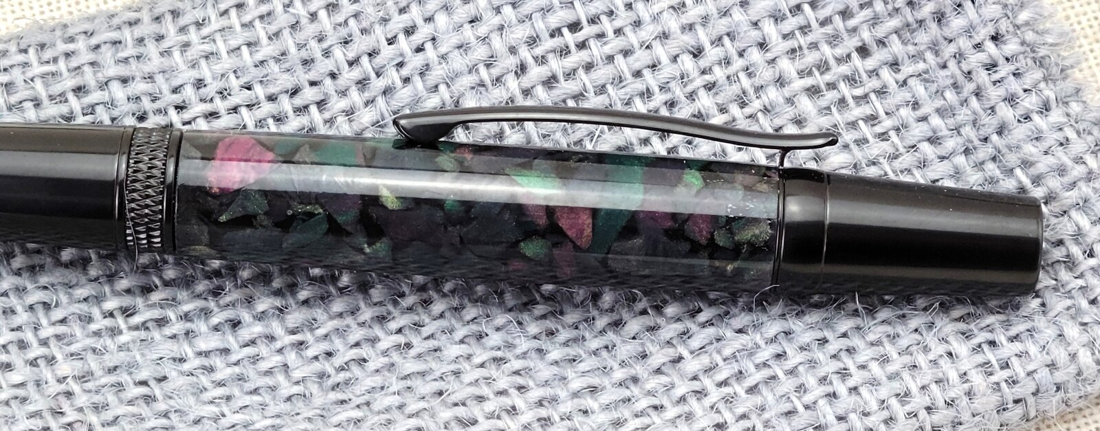

Diamond knurl with a pomegranate crush rhino plastic blank. No finish added, just polished it through the zona grits and the same plastic polish. The blank had a little bubble in it and the epoxy looks a bit rippled at the top end even though the black paint held up quite well on the tube and blank (there was plenty of room for the glue without friction).
