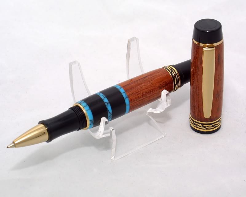

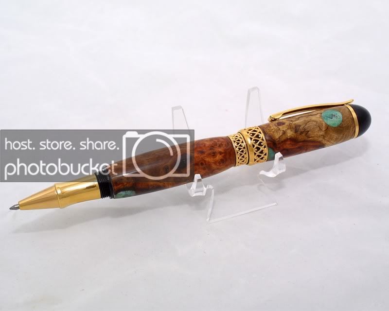

This one is Bubinga with ebony and turquoise tru-stone. It's not bad out of square, but enough to notice. I love the mix of colors, but not the final product. Bubinga and Ebony are probably my two favorite woods to work with or turn so far. Olympian Elite gold kit.

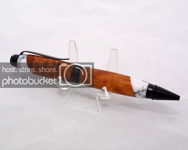

This is (I believe) Afzilia burl and marble Tru-Stone. Again, it looked better in my head, but I'm not totally disappointed in it. Black chrome cigar kit.

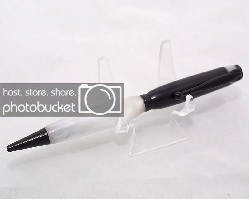

Black slimline kit with Pearlite acrylic and ebony. I painted the tubes silver before I glued them in, but some of the paint rubbed off and you can see hints of brass if you look closely at the pen. The top piece of acrylic either melted or something that I put on it ate it away because it got damaged somehow. I tried to polish it back up as best I could, but there's still evidence.

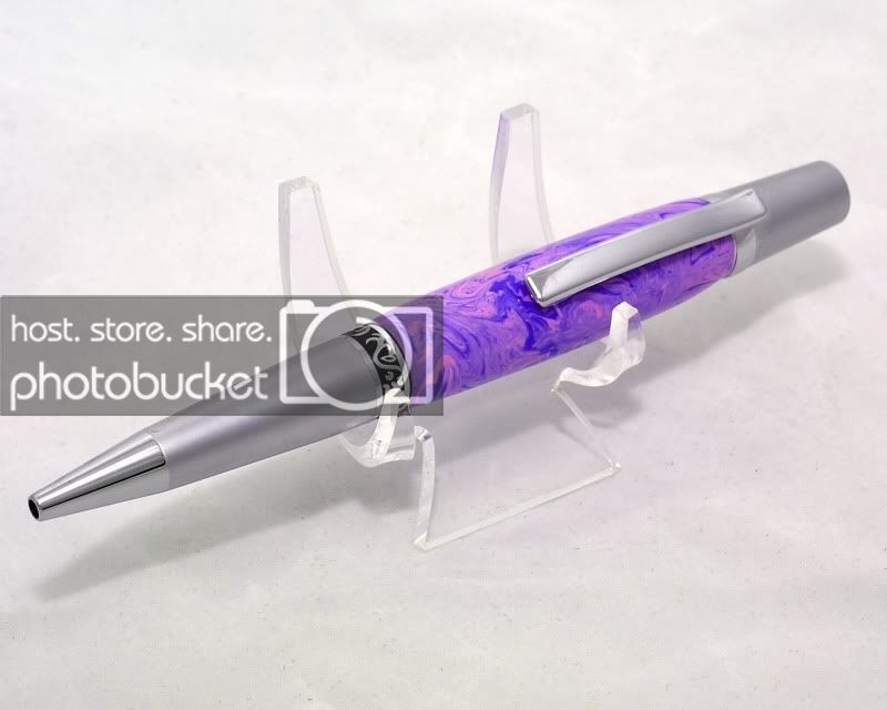

I may put this one back on the lathe to clean it up a little more, but the combo makes for a nice looking ladies pen. Just a basic sierra with an unknown acrylic.

That ladies pen is really looking good Chris. I like the purple on that one and all the swirls. Really fantastic job imo.

ok, 5th is your best, it's not busy. 1st one ther is no balance in the wood and the black and the blue. had you used acrylic instead of the wood it would have worked. 2nd one, yor wood is much prettier than the marble, no visual balance.
third one not appealing 4th you already the problem. Pics. very nice, turnings very nice. Hope youwon;t take it personally. i am looking at it from a buyers point of view.

1. The reason it out of balance is that there is too much black in the pen. The black nib, the two wide ebony pieces in the pen and then cap. If you reversed the turquoise and the ebony you would have been fine.
2. The pen is balanced,yet you used the wrong contrasting color. You selected a color that does not complement the main color of the pen, Aflizia burl. it fights it.

4. Working with slim lines is tricky. Review Russ Fairfield tapes or web site. He has many creative ways to enhance a slim line pen. Your pen is not fully in focus. [bad for web sales] Then photographing micro-photography your depth of field is reduced by 2/3. Just be careful.

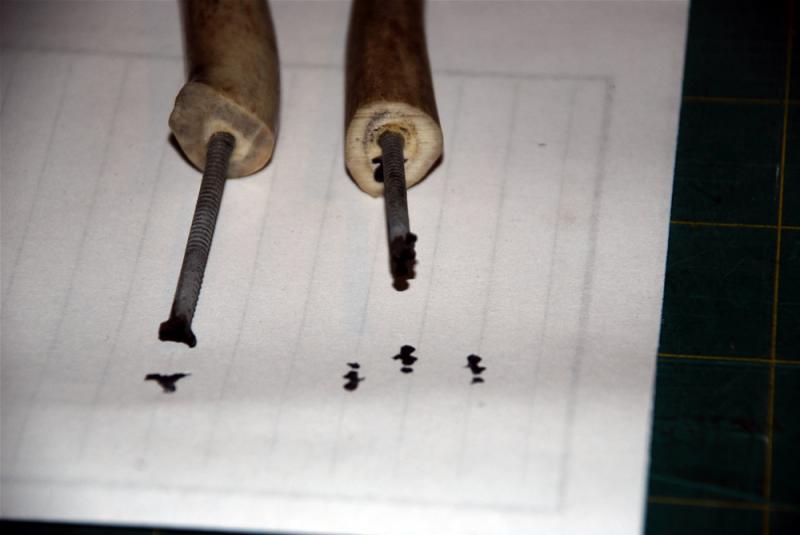

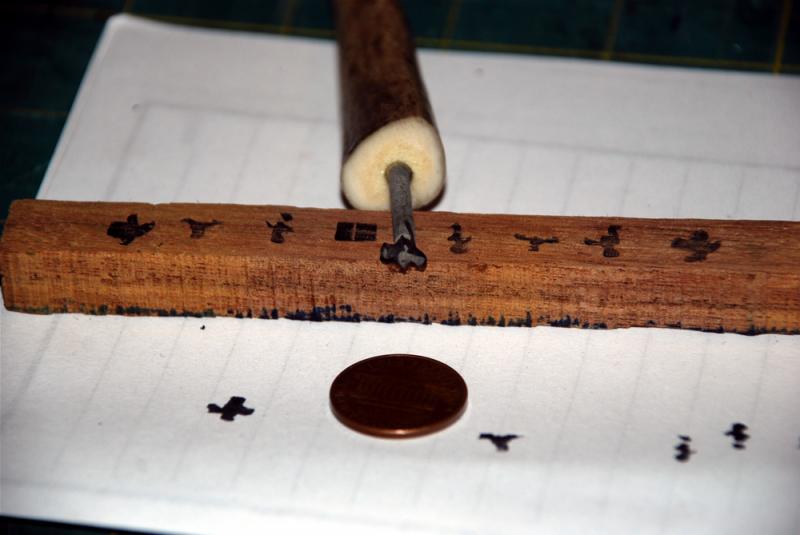

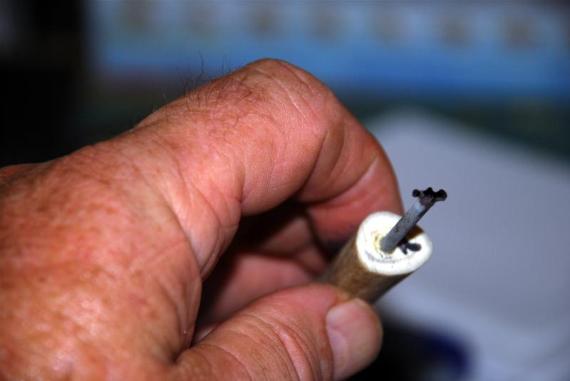

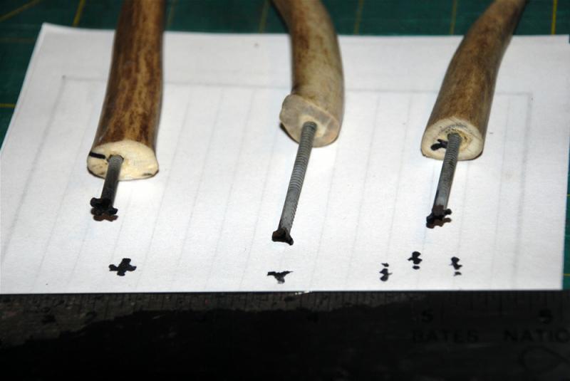

My signature on pens is lower case jg. I took a nail head and filed the jg on it and burned it into some woods.
Okay, I made a trip to the shop to get the pictures.
Don't make fun of my branding irons, I have already taken enough "shots" for the day. Branding Iron 5.jpg
Everyone's has their opinion.
As an exercise put together a folder of pictures of segmented pens that you like. Get thirty to fifty of them. Then review / draw out the pen in a box divide the box into nine equal squares. three across and three down. Then review where the elements of segmented pen. You will see the element of composition whether good or bad its a learn exercise also study the color chart. Do the colors complement one another or contrast one another.
Bill, vey good pointer. I think that's a great idea to improve on. Way to go.
John that's very inovative how did you that? Did yougrind the end of the nail? Man you are a true artist. I thought it gives it a unique signature.
Jewelers files. Just kept gnawing away at the head until I got what was intended. The error was that you must remember to do everything back wards. I intended to heat these irons with a propane torch. Each wood reacts differently. Some worked and some did not. I thought antler would look great but gave up. I could not get the branding iron hot enough.
