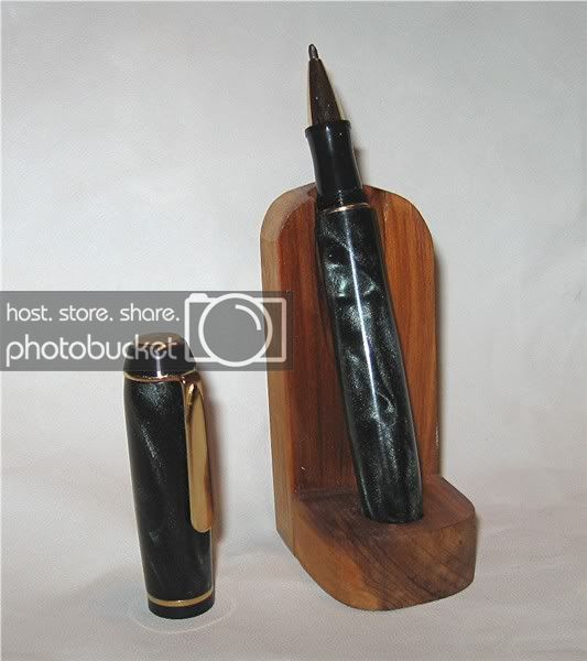

(A Different) Modified Robusto
See more from hrigg
hrigg
Nov 8, 2006
217
Spokane, WA.
About all that's left of the Robusto is the clip. There's a modified El Grande Centerband, an El Grande rollerball nib, and a Fisher Space Pen refill that needs the plastic spacer trimmed another 1/16. The barrel is too short for a rollerball refill, but you could use a fountain pen nib and cartridge. There's only about an inch of tube in the barrel, and the hole for the refill is too small in diameter for an ink pump. Not shown is one of Arizona Silhouette's Doo-hickies inlaid in the closed end of the barrel. I couldn't get a good picture of it.
