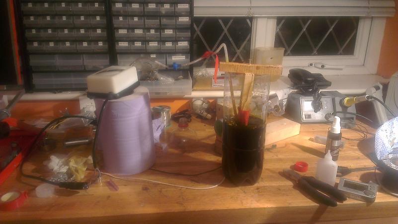

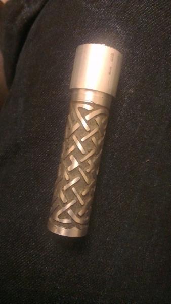

I am so close to pulling this off... the amount of experimentation i have done to get this far is untrue in itself though i feel like ive nearly cracked it, with one mask on this piece working perfectly, and the other failing which was meant to protect the closed end half of the pen and rim. Tomorrow night i will turn a new pieceand restart the process though this time it wont be closed end..simply because i dont have my chrome plating tank yet so i may as well use the chrome end piece from a kit for this project.
The theory behind this is once i have acheived a succesful etch of around 0.5mm while minimising under cutting (done this already testing) not quite anisotropic, but certainly not full blown isotropic etching, i will then use black inlace to fill the etched voids and polish it up...
I appreciate the info above is a bit vague at the mo with regards to what i am using for masks etc, but until i get this 100% correct i don't want to share information and send people down the wrong path by mistake. but bear with me... once ive got this down to the tee, il type up the whole process and share it with you. until then, stick around for the journey :) im hoping to to crack this one soon
Couple of pics attached,

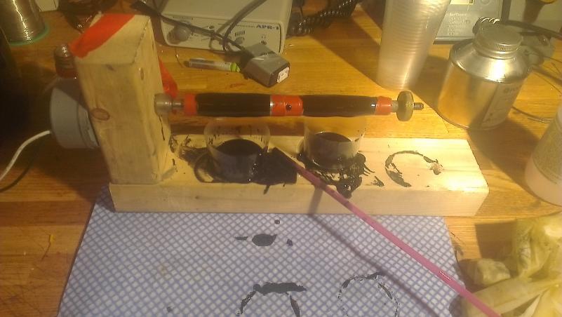

one showing a prototype etch tank
the other showing tonights attempt

So long as the turner is using the same mask, and the same etchant recipe, then i see no reason why anyone would get different results, other than by how long they leave it in the solution for. I seem to be hovering around 30 seconds (yes you read that right, 30 seconds to remove 0.5mm - its quick) obviously the longer you leave it in the more will etch away and the greater the damage with regards to under cutting... dont leave it in long enough and the cut wont be deep enough to take resin for instance... but of course you can keep taking it out and looking at it every 5 seconds if you choose to and just putting it back in for another 5.. its easier to take it off little by little, than it is trying to put it back on again ;)
The good news is, that although the etchant is corrosive, its not particularly harmful so long as your not silly with it... EG wear eye protection and an apron, though thats more to protect your clothes from being stained by the yellow Ferric Chloride. in this i add Citric acid (same used in sweets and beverages) which creates an edinburgh etch. This helps remove the smut from the work piece which acts as an insulator stopping the etch going down and then it seems to work outwards more creating an under cut where it eats away underneith the masking. I use an air pump to help here too. I also have another metal dissolved in the bath which creates an exothermic reaction with aluminium, hence the 30 sec time. it gets hot, rapidly quick, so much so wax masking just melts off in seconds... dont mess around with this until ive done the how to video

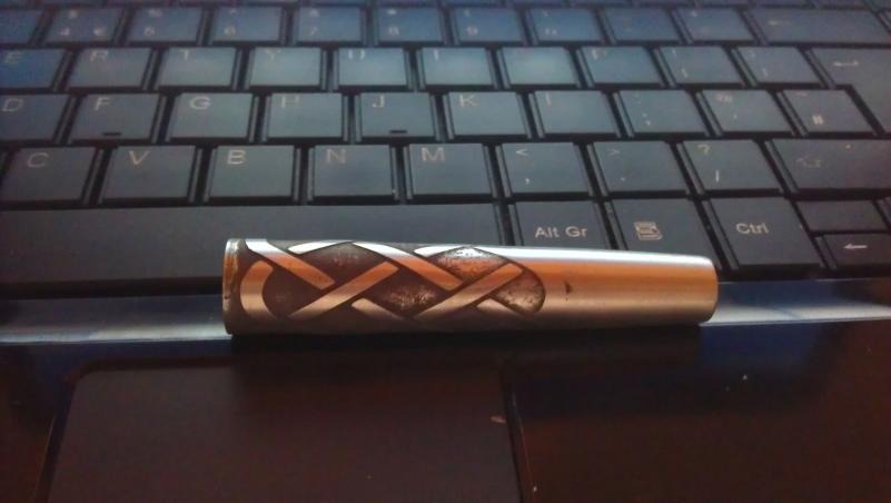

At last!!!!!! :RockOn:
So i am now happy with my method of etching. the lid is complete, and went very smoothly. Even to the degree of moving from the tank twice and washing it to get a good feel of how deep it was before continuing a bit longer.
I know its not too pretty to look at, but once its been cleaned, inlaced, sanded and polished this will be a beauty
tonight i hope to do the pen body, and if time permits, il get the inlacing on too... it takes a couple of days to cure, but can now breathe a nice sigh of relief. Rum & coke required me thinks :party: :drink:

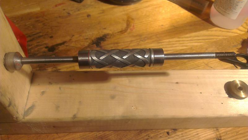

and thats that job jobbed.
Resin applied to both sections of the pen, using my pen finish Rotisserie, which rotates at 2.5RPM. Jeff Powel was kind enough to share his design with me over at masterscroller.com Thanks Jeff, it was a great idea
So time to put my feet up for a couple of days while this cures well :cool:
PS i think im high off resin fumes. added bonus

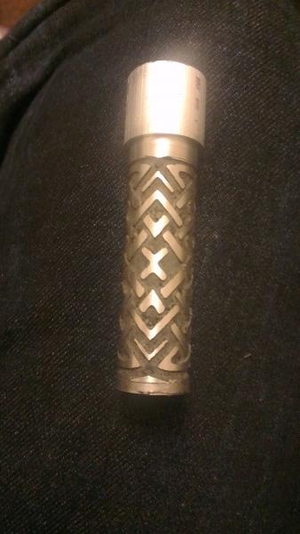

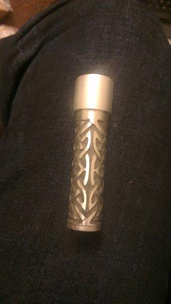

Here we go again
Etched a touch deeper... maybe a little too deep.. will see how it holds up when i drill it.
I have a different type of filling in mind for this one though :wink: though that wont be delivered until mid week at a guess.. no doubt this one will be finished for next weekend
I should add, the three pics below are of the same blank. first showing the back, second the front, third the sides
