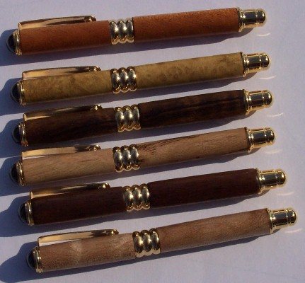

I don't usually post pictures of pens but Scott said I would be perfect if I turned pens so I had to show him some. He didn't say anything about photography.
Six pocket pens.
Top to bottom:
Angle cut goncalo alves
Honey locust burl
English walnut
Grape
Black walnut
Bigleaf maple

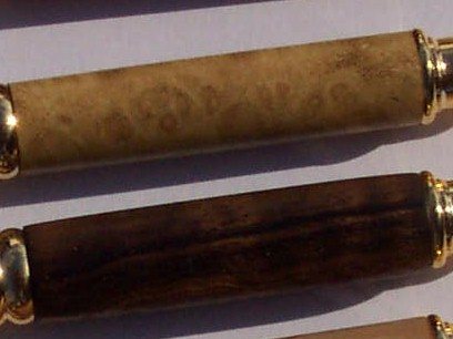

Close up of locust and English walnut.

You know, by doing this, you have sunk to our level! [:D] You may have also, unwittingly, left yourself open to a new addiciton! Only time will tell! [;)]
The pens look great! What finish are you using?
Scott.
Frank, the kits are Small Pocket/Purse Pen N-Series from Berea. You can find the kits on this page. http://www.bereahardwoods.com/new/other_items/other_1.cfm#3
Scott, I do turn pens I just don't get real fancy with them so there isn't much to show off. If the photographer got any worst I would have to fire him but he is too stupid to fire himself. I use a home brew finish equal parts linseed oil, pale shellac and alcohol. Occasionally I will use CA glue with the brew if the wood is particularly soft or porous.
On antler I usually seal it with thin CA glue, sand and apply thicker glue if necessary to achieve a smooth surface. Wet sand with 1000, 1500, and 2000 wet dry paper. Then polished with Meguiar's #2 Fine-Cut Cleaner and followed by Meguiar's #9 Swirl Remover. I first used Meguiar's for polishing the top of an English walnut coffee table. (http://www.woodnheart.com/webpage/Furniture/01ct.html) I shouldn't give away my trade secretes but your local auto paint store has more finishing products than a pen turner could ever use.
