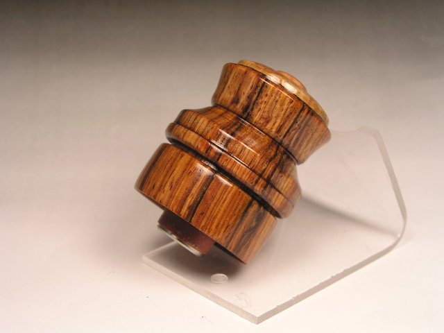

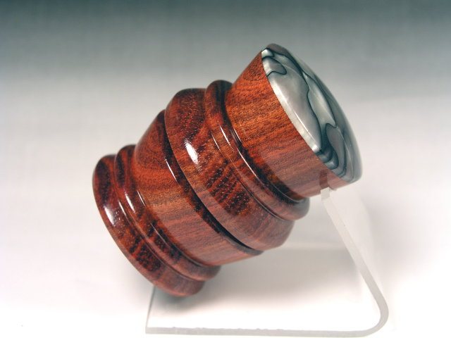

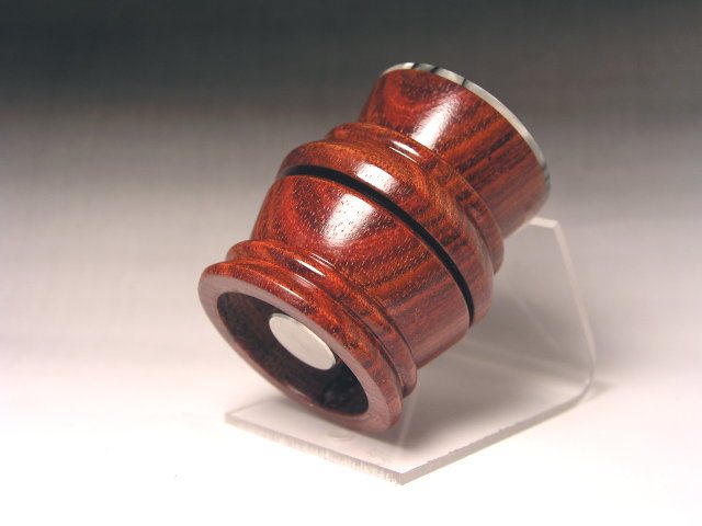

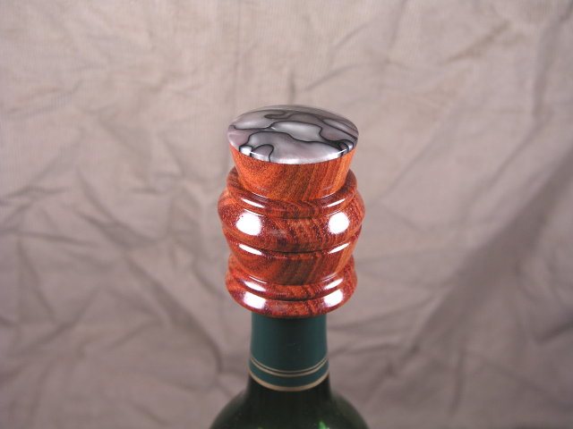

I have been doing some work with the new Stopper Kits that Bob Gnter came up with. They work really well in actually "Stopping" the liquid in the bottles. They are a little bit more challenging to turn, but results ina unique design possibility. Each stopper has two pieces that Ar turbed. It reminds me of turning a very small peppermill. The top wooden piece is rotated while the lower piece is held with your other hand. The rubber stopper expands in the neck of the bottle.
The first one is Bloodwood with an acrylic cap:
THe above photo shows the mechanism hidden inside.

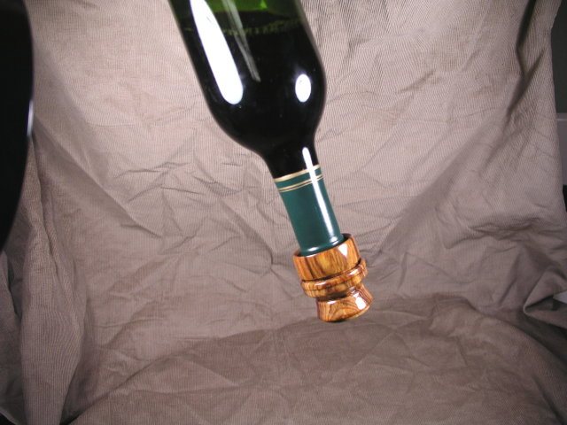

The Stopper in Action.

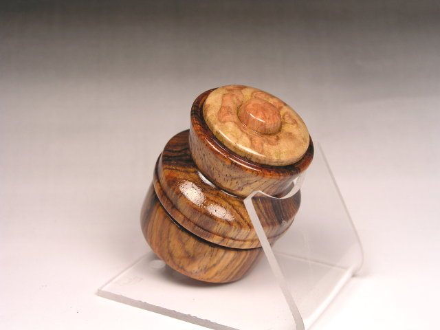

Next is a Mexican Cocobolo. The Top on this one is a piece of Red Mallee Burl (Sapwood) scrap. On this stopper, I wanted to see if a smaller stopper blank could be used by leaving the rubber stopper exosed a bit. Works just fine. I like the appearance too.
Thanks for looking.

I may have to take up drinking just so I can put some of these great bottle stop designs to good use. They look great and I just can't say enough about your finish. Still trying to emulate your results with CA and I may just succeed... in twenty years time.[:D]
-Peter-
LOL... Thanks Peter. I finish my stoppers with Deft Spray lacquer. It works great and really makes a difference. Three coats about 20-30 minutes apart. Then let cure for a couple of days. No buffing after the fact.
Fangar

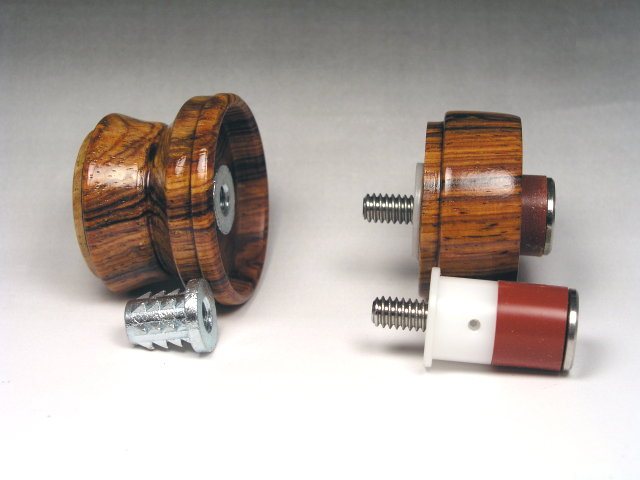

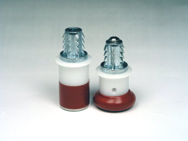

Can you post a photo of just the mechanism while we wait the arrival of the website? Those stoppers look good, but need to get used to the missing "cone".
Cheers,
Draken
Thanks for the kind words. I am working on the web page now. It should be up soon if I can get some darn time. Here is a photo of the mechanism. The left is relaxed, the right is engaged. The metal anchor is pressed into the top form. The unit is like a pepper mill where there are two pieces. The bottom portion gets glued into the lower form. I will let Bob know that he has a line forming. I will see if I can get a direct email to post where you guys can get some prior to the sites completion. His instructions are pretty bad right now. I am writing a new set with photos.
