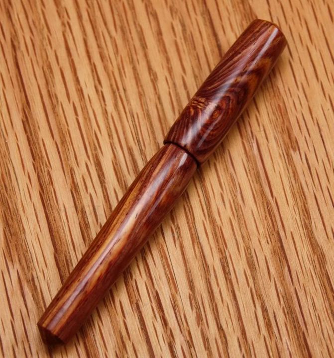

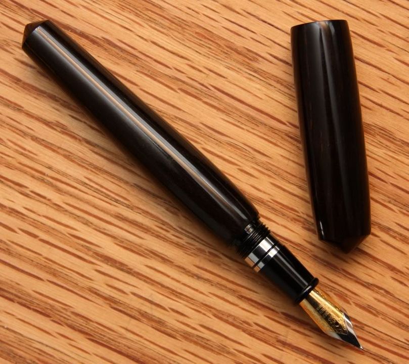

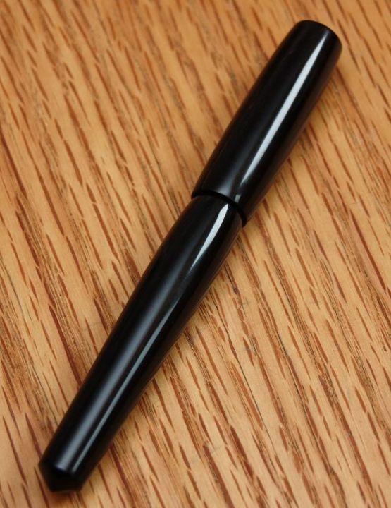

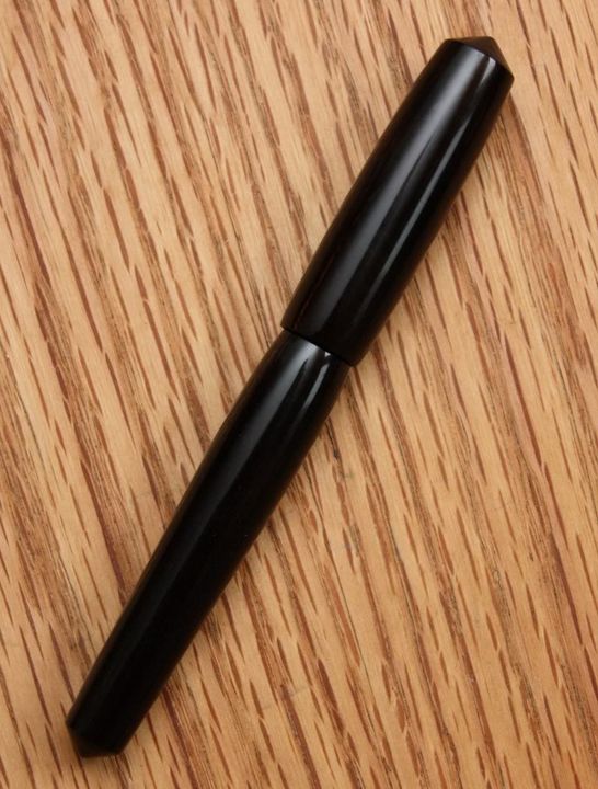

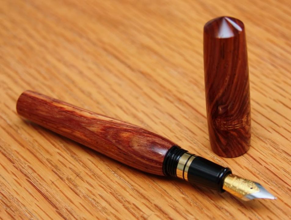

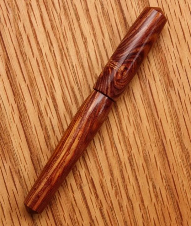

Here's a couple more clipless pens that came out of the shop this week. The first is of cocobolo, the second ebony. Both finished with CA.
Thanks for looking
Ken
Nicely done on both counts, but that ebony pen is fantastic... Probably the best finish I've ever seen on a piece of ebony.
G day Ken,
I join the group that says that is the most beautifully finished Ebony ever for mine as well. Love the Cocobolo it is superb. Clipless etc all combined to two outstanding pens and pictures. Feeling bold to say so but a suggestion with that busy background try pics with a plain one those pens deserve front of house billing.
Masterpieces in Tandem, congratulations.
Regards Peter.
Very nicely done! I like the points you made on the cap and on the end. I think it adds to the over all look. Both have nice finishes too. Well done!

Hey There,
Really nice pens, I like the concept, What type of Mandrel did you use.

No mandrel. Just a jam chuck out of a piece of scrap wood glued onto a piece of 3/8 roundstock.

Those are both really excellent! If you don't mind me asking, what are you doing for the cap threads?
Heh...shamelessly cheating. I have been using the section and thread insert from an El Toro FP kit. Have done similar things with Baron kits, and the El Grandes are up next. The plan is to go kitless eventually, but need to learn more - tap and die use, turning my own section etc....

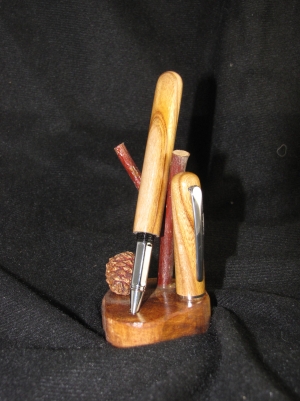

Hidden clip pens can be a bit tricky and tedious but quite doable.
Go to Russ Fairfield's web site and purchase the 4th video, something about collectors pens and that will show all.
This is one of my attempts
Nice! Fashioned out of a Baron, it looks like. Gorgeous pen, beautiful job on the clip!. I will have to check that out, thanks for the tip.

Fantastic pens. Can you talk a little about how you hid the cap components? Great photos.
No problem. Only hidden component is the thread insert, which is from an El Toro pen kit.
Ken
How do you prevent the thread insert from being accidentally pushed in too far? Is it epoxied in place?
Ya. I thread the insert onto the threads of the section (without the nib in place), smear a trace of epoxy into the cap, and slide the thread insert in to where I want it, while lining up the grain/figure where I want.
