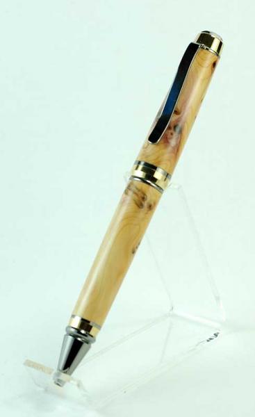

Whaler Member Joined Aug 16, 2005 Messages 1,707 Location Sequim, WA, USA. Jul 20, 2011 #1 Hybrid Cigar in Black Ti/Gold wrapped in Yew Burl. Sanded to 400, 8 coats of BLO/CA, buffed with Autosol and topped off with Ren wax. Attachments YEW.jpg 13 KB · Views: 292

terryf Member Joined Jul 10, 2010 Messages 1,276 Location Pretoria, South Africa Jul 21, 2011 #5 Very nice cigar - what made you decide to use metal polish on a wooden finish?

Whaler Member Joined Aug 16, 2005 Messages 1,707 Location Sequim, WA, USA. Jul 21, 2011 #7 terryf said: Very nice cigar - what made you decide to use metal polish on a wooden finish? Click to expand... After you complete a CA finish you basically have a plastic pen. Using the Autosol, I find that there is no need to sand the CA finish PlastX works as well.
