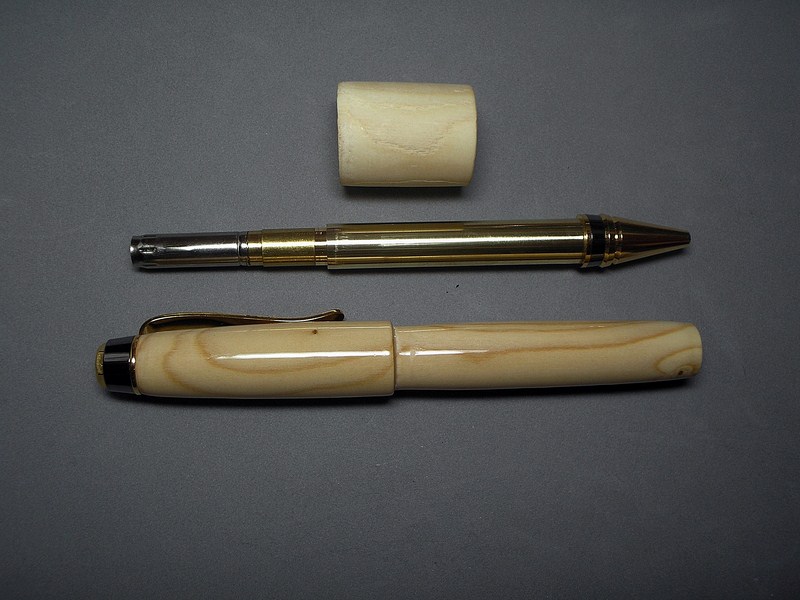

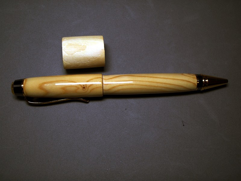

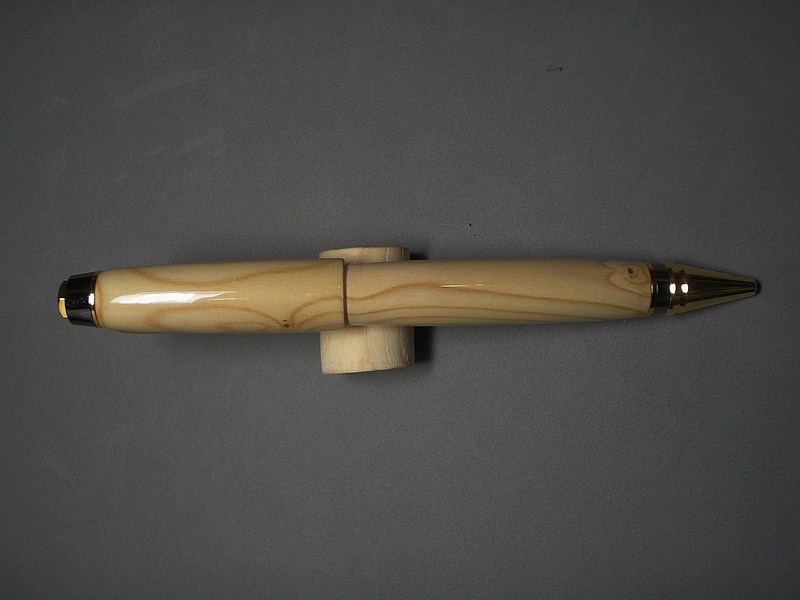

Just took this off the lathe.
This is one of my One-Piece Cigars dressed with Lilac from a tree of a young man's (monolith) grandmother.
The shape is a blatant copy of Larry of Harrow's (and Mack's) rendition of the Long Click Pen.
The left over piece of Lilac is used for a prop to show the difference from raw wood to popped via Defthane.
I used Defthane Lacquer (which penetrants the wood) to get the grain to pop and then finished with 4 coats of Med CA and polished out with Tri-M-Ite polishing papers.
Very good match on the grain - super looking pen.
Well, if I understand it right, the blank never was cut, the step between the cap and bottom part of the pen is false, the mechanism is a single piece that turns at the nib point, I believe. Someone correct me if I'm wrong, please...!
In any case, is a great "illusion" and well thought by its originator...!:wink:
You are correct George ...
Thanks ... Larry did this first on a Long Click pen and I liked it so I did my version on a Cigar.

If you are in reference to my pen it twists from the nib to open and close the refill.
My pen did not have the grain like his as I cut my black with the round growth rings.
This showed absolutey zero grain when I turned it to size. The grain in the wood 'popped' after using the Defthane.
He must have pushed the top of the pen just right to match up his grain when the point was not sticking out.
No matching up of the grain here, it's a one-piece pen body. The larger top barrel gives the illusion of a two piece pen.
The instructions for my method of making it is here. http://www.penturners.org/forum/showthread.php?t=77365
