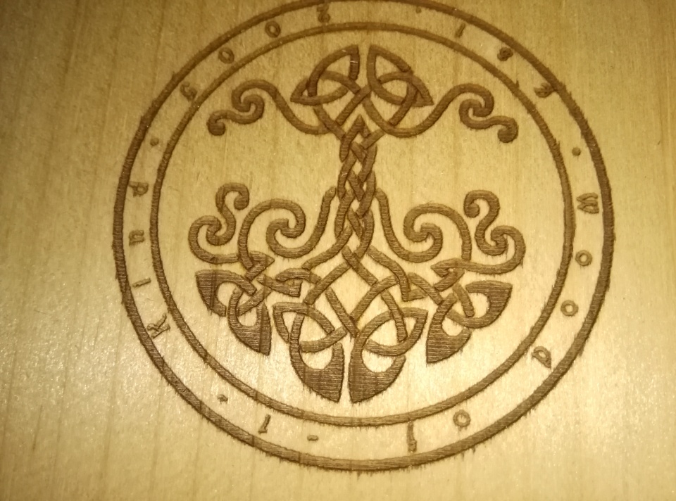

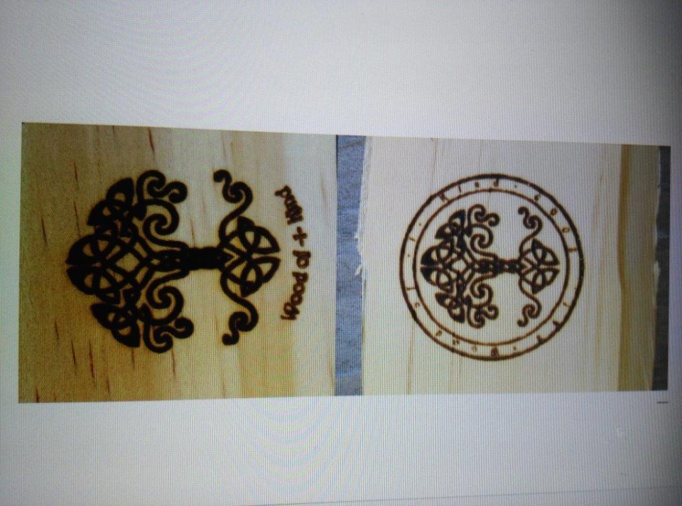

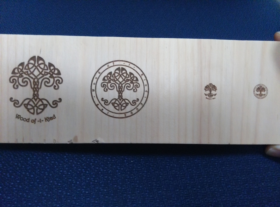

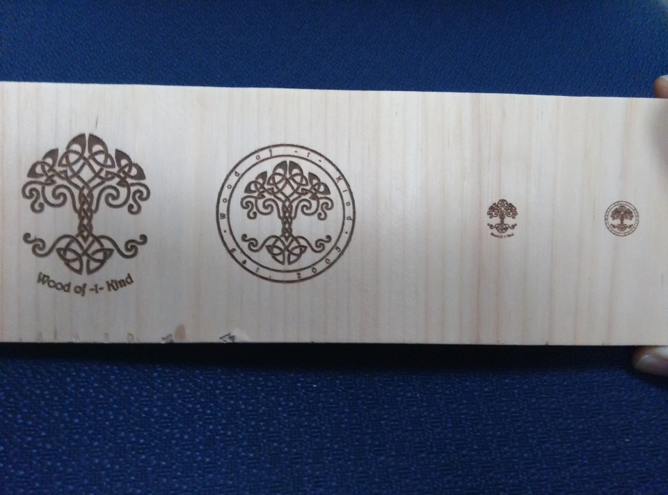

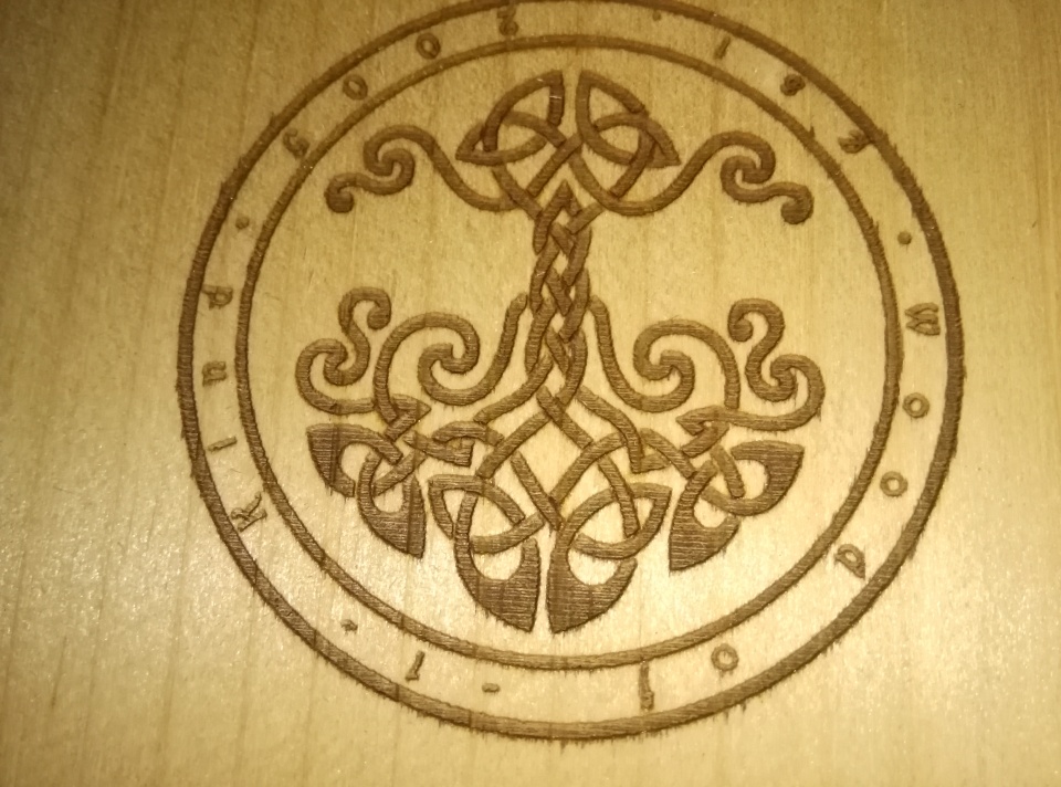

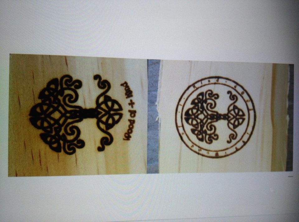

Rather than adding my personal thoughts on the subject matter, I decided to start this discussion. Like others, I have been debating as to whether or not I should purchase a laser to help with promoting some of the items that I make. It became a no brainer when one of the IAP members here was kind enough to do a test run on the Chinese laser using my logo. Glad to say that I am pleased with the results (picture) attached. However my story does not end there. As an informal and non-scientific experiment, I got another friend to do a similar test with his rather expensive laser using the same logo.
Remember that one is $90 and the other is priced in the thousands. This is what I would like to share with the folks here on IAP. Not trying to engage in any heated discussion as to the merit of one machine or another. Just look at the photos as they are merely intended as "food for thought". Which image is from the cheapie laser and which is from the >$$$$$$laser?:biggrin:

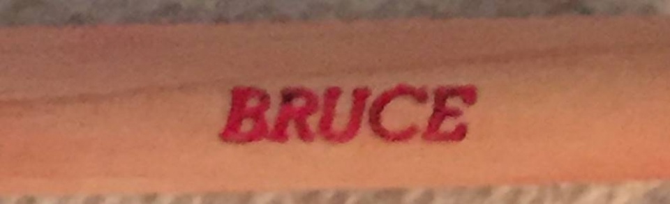

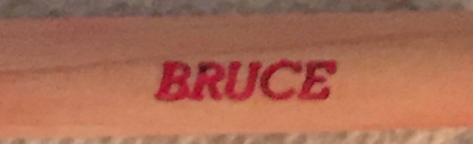

My concern about the cheap ones is the power / depth of the engraving?
Can the cheap one be easily sanded off? Is it deep Enough for a color fill?
Not easily sanded off, deep enough for color fill. First attempt; maple, CA to seal, Laserbits pro color fill heavily applied then sanded flush. Probably could have let it dry a little more, but proved concept. Have also tried Rub'nBuff on darker woods and that seems to work as well.

So you're adequately satisfied to engrave a name on pen for a customer?
Thanks for the input.
If I sold pens, I would answer yes. Requires a little playing to get the right size and settings but definitely can work. If I was in the business of selling a lot of pens I might consider a better unit but for the price it's hard to go wrong.

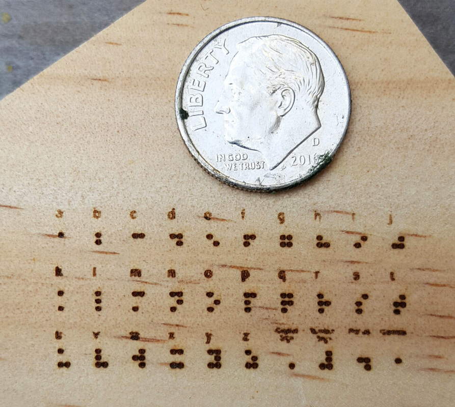

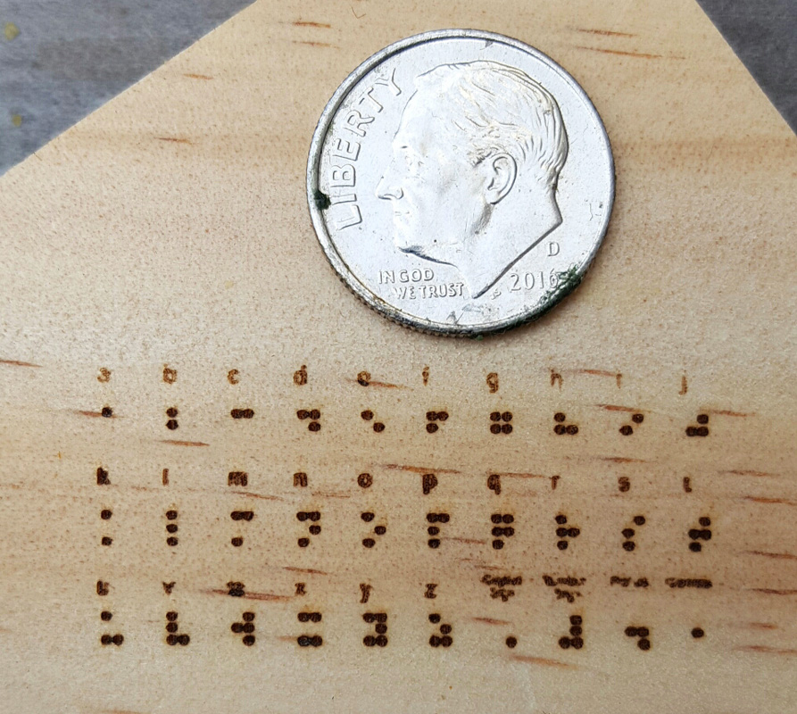

Hi Sharon - You kindly alerted me to anti-Windows-10-upgrade software - one good turn sparks return - here's a quick burn of the braille alphabet from an (nbp.org) alphabet card - pdf opened in Photoshop, saved as .jpeg, dragged into the laser printer software, burned after quickly focusing (could have been better) - speed = 45.
I know you'll do a lot better - and this is tiny - like your raised dots idea - have fun.

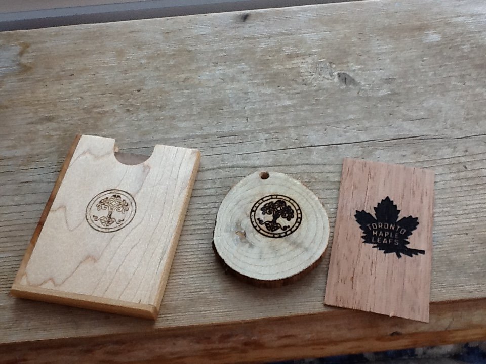

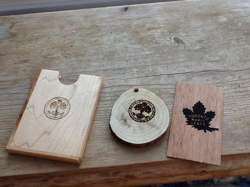

So after a prolonged wait, I now have the laser. Glad to report that I am very happy with the performance so far. A very good value for money and I certainly am happy with the logo.
Conclusion: you do not have to spend a fortune to get more than "acceptable" laser results.
