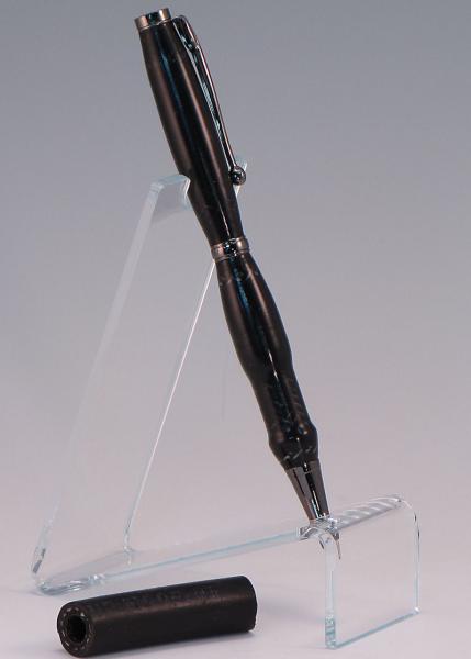

Rubber Hose Pen
I recently turned a slimline from black rubber hose. The hose is fairly flexible, to me it doesn't feel any harder (or softer) then a rubber tire. It turned fairly easy (certainly not like wood but...) with standard tools and easily sanded as well keeping in mind what robutacion covered above when sanding. The previous posts mention using flexible CA on rubber but this was done with regular medium CA. I have some flexible CA but never thought about using it for this. The only real problem I had with it was the nylon mesh reinforcement fibers would not cut very cleanly. They acted a little like soft end grain. I solved the problem by periodically soaking them with thin CA as in soak-dry-turn-soak-dry-turn etc.
Here is my original posting for the pen. http://www.penturners.org/forum/showthread.php?t=78222
