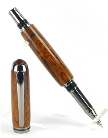

Desert Ironwood (from Joe Suckley) is fast becoming one of my favourite woods to turn, even though it makes me sneeeeeze like crazy!

The DI has been buffed with Formax buffing compounds followed by a buffing of Carnuba Wax to retain it's soft warm feel.

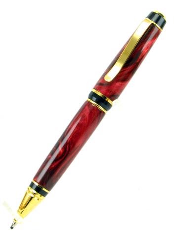

This Cigar pen has been turned from a Brooks 803 blank (no name for the blank given).
I used the Woodchuck 4" rad. cutter to turn, then sanded from 400 to 600 grit parallel to the ways of the lathe, followed by a rubdown with 0000 steel wool. FLITZ Metal Polish and Fibreglass Cleaner was followed by Meguiar's PlastX Clear Plastic Cleaner & Polish.

Good looking pens there Mack , I was lucky enough to get some of the ironwood from Joe ,and none of the pens made from it have dissapointed :)
Cheers ~ John
Beautiful pens, Mack. The DIW one really catches my eye,
love the matching finial.

It took 3 tries to get a finial I could use. I blew the first one up, forgot to undercut the 2nd one so it wouldn't sit down flat. The 3rd one is a little more angled than I really wanted, but I wasn't about to start on a 4th.
Besides I was running out of shorts of DI!
They're both great Mack! No name for the blank...I make so many different kinds that naming them would take forever! I like the finial as well. Superb!
