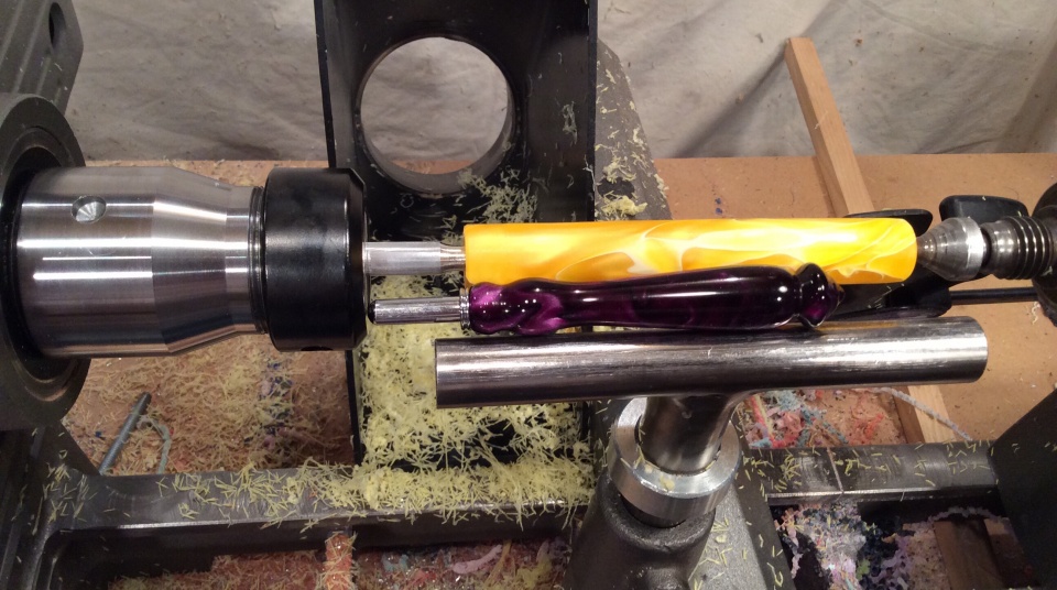

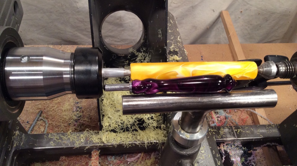

Hi Dan,
That is what I have on the lathe right now! I used a piece of 3/8" aluminum stock from Home Depot. I turned the end down to fit the tube with a snug fit. It just took a while. I tried HSS, carbide and then files. I finally got there. I used tail stock support while turning the aluminum.
The turned section extends the full length of the 8mm tube. You will notice I did not leave a shoulder for the workpiece to butt against. I want to be able to turn and finish the open end as well.
After turning and finishing, I will then part off the small bit at the closed end and finish that without tail support.

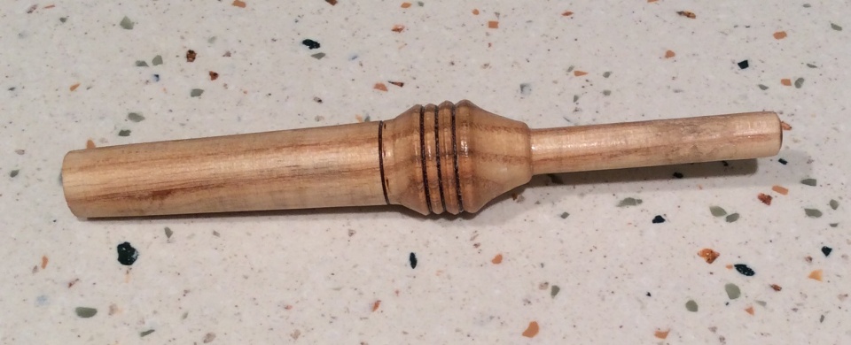

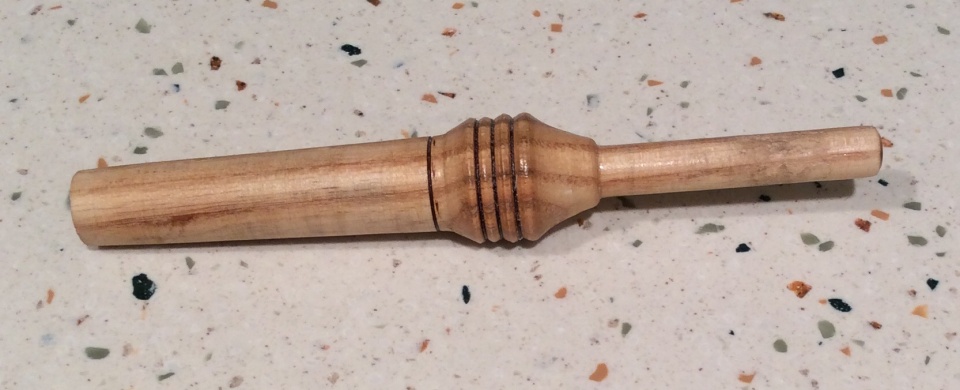

Hey Dan,
Here is another one I had laying in the shop. This closed end mandrel has a #2mt on one end and the other end is whatever size and length you need. You can use some blue tape if your blank fits a little loose.
I turned some of these when doing a whistle turning project with two dozen bible school kids last summer.
You can also check on a pin chuck for the job. If CSUSA doesn't have one, Rick Herrell can fix you up.

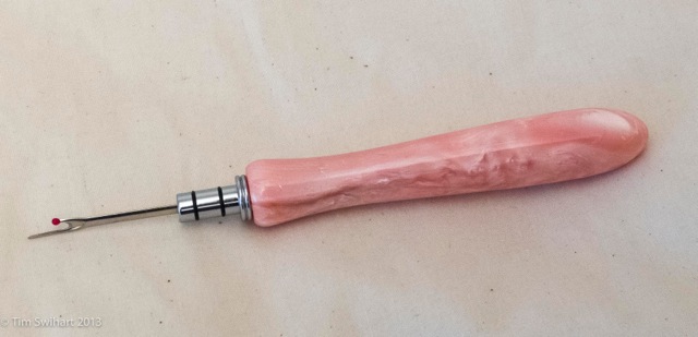

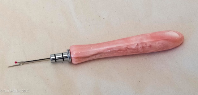

Since you plan to make multiple, why not pick up the 8mm expanding mandrel? I used one late last year to make a closed-end seam ripper in TruStone. The mandrel was well worth the slight cost (though I would've sworn the mandrel I have came with the ability to do both 7mm and 8mm).
I definitely prefer the look of closed-end seam rippers.
