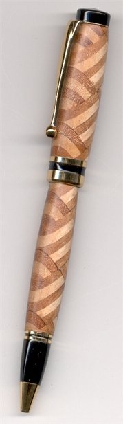

Alright 75 pieces is an estimate I did not actually count, but it got your attention. I like the way this turned out but I do not love it. Let me know what you think.

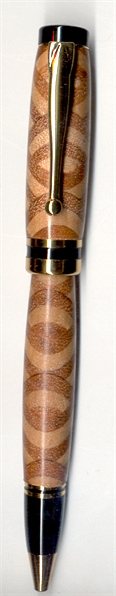

Sorry the 2nd picture is not better:(
Comment and critiques are appreciated.
I generally like segmented pens and this one is no exception. I appreciate the work that goes into them and it is obvious that you spend a good amount of time on the glue-up.
I think anyone with an eye for detail would really love this pen!
Mike,
That looks to be a lot of cutting and gluing! Nice. What kind of wood is it and what glue type did you use?
I actually like the first picture. It would be flawless if one or two of the lines met up just a little better on the side shot. Even then, i would be VERY proud to have produced something that looks as good as this pen does.

I know I am probably butchering this wood name but Gonca Alves?? and maple. I used regular titebond wood glue to glue up the 5 lamination strips, then once they were cut into squares I glued the squares together with CA.
Nice work. The hardest thing is to get repeatable patterns, you came very close but looking at these photos there is still seems to be some misalignment. Once you nail it down you find people just stare at it trying to find something wrong.

The pattern was actually closer than I thought it would be, but definately off in a couple spots. I screwed up cutting the squares and had to be creative when putting them together. I have 2 more sticks of my lamination that still need to be cut into squares to make another blank but I doubt I will. I did not bet the "Bang for the buck" out of this that I wanted and with the dissimiliar material and all the end grain and different grain allignment it was a nightmare to turn.
I think I ended up grinding 1/4 inch of my skew sharpening it so much[;)].

I really like a well done segmented pen mostly because I am in awe of them. This one I especially like because it is so subtle. Very nicely done. As mentioned, I am in awe.
