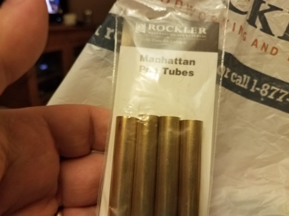

Rockler has Manhattan tubes which are exactly the same. They also sell PSI Gatsby kits.
Gatsby = Manhattan = Sierra or am I missing something?

Are they? Great! You would think that Jim would have told me that when I was there yesterday. I appreciate it.
I think Manhattans are rockler "Brand" and Gatsbys are PSI so I think they push the Manhattans. They are near the bottom of my store. I like Gatsbys the best because they appear more finished.

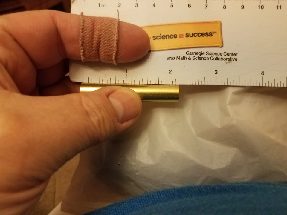

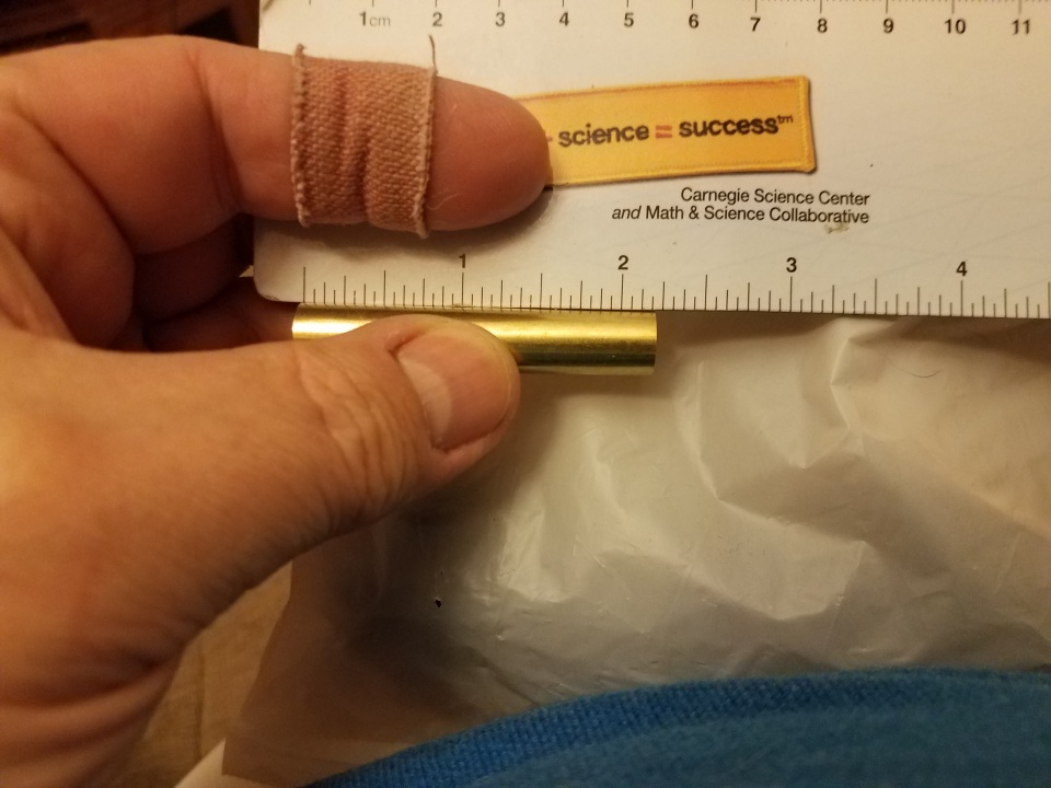

Does this help?

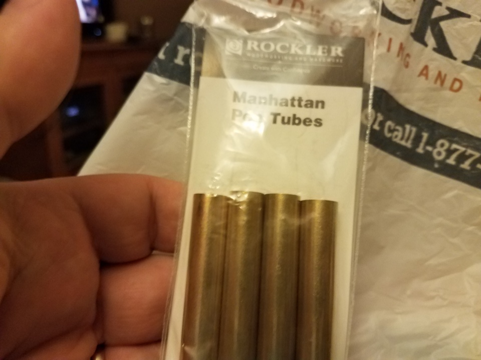

Thanks to everyone who replied to this question. I picked up the Manhattan tubes last night and they worked great! Check out my latest post under "Show your pens" to see what I did on them.
For future reference, you can look at all of the kit dimensions on the IAP bushing and tube charts.
On the Rockler chart you will see that both Gatsby and Manhattan are 27/64 (as you know), but the Manhattan is 0.04" shorter (which is probably not noticeable in this case). Note that the tables are organized such that Page 1 is shows the tube and bushing part numbers, Page 2 is the dimensions for all of the kits on Page 1, and Page 3 is a continuation of Page 1. This was a little confusing for me at first.
