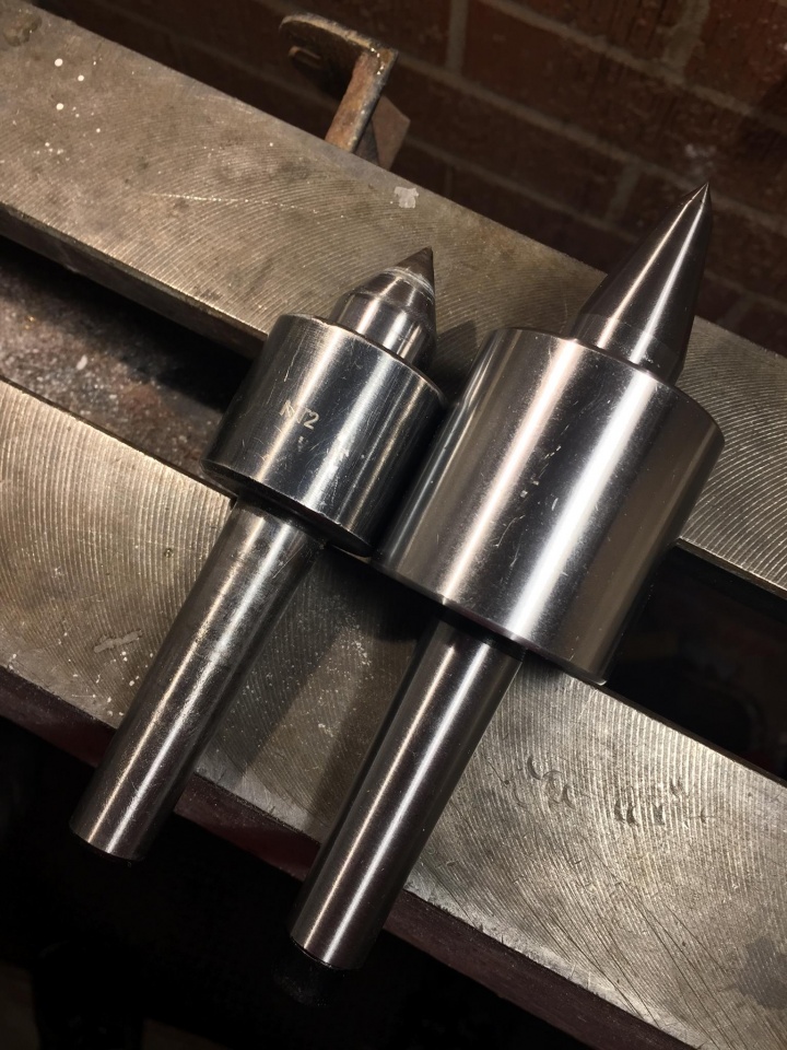

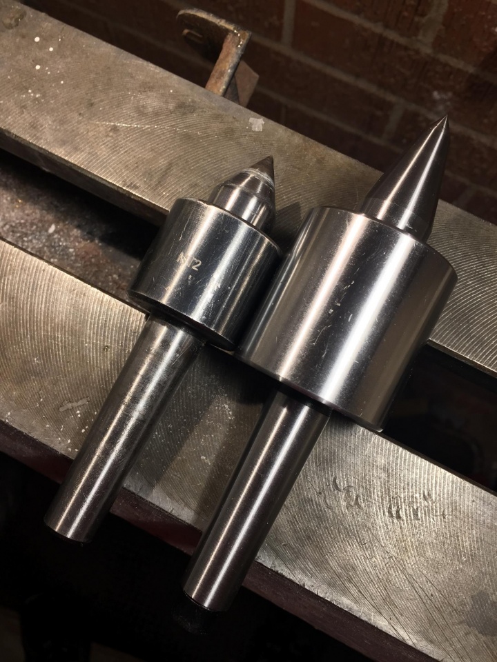

Keep in mind to that not all 'live centers' are good.
Personally I love the one on the right side :)
attachment.php
