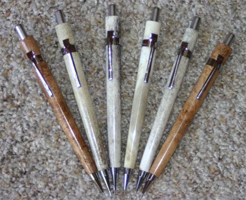

Here's a picture of 6 pentel pencils off to a CPA in Florida. Four are antler and two are mesquite burl. Enjoy and comments welcome.

No need to apologize Frank. I'm not real sure the pen is that great looking either, but they are used by many CPAs and engineers and at $35 each, I don't mind making them. Not an easy pen to make...but when it works out its not bad. I had to do 9 to get the 6 successful ones. The wall is really thin at the bottom and if things aren't running true the hole will be exposed about 1/4 to 3/8 inch above the writing end. Thanks for commenting and being honest...I ageee...antler and mesquite burl are hard to beat.

Don,
The clip bands almost look like they slip over the finished pen. Is that the case?
Yes, Ron hey do. Slide over from bottom to top and if the pen barrel is too large then the clip leaves a mark. This is one of the problems with making this kit. But holding the clip tip off the pen stops the marking of the finish. The band at the top of the clip doesn't seem to mark the finish. I just sold 8 of these to a CPA in Florida...5 antler and 3 mesquite burls.

Well, while I have to agree that Pentel pencils are approaching the pinnacle of tackiness, there isn't anything tacky about selling them for $35 a pop. Very nice work, especially on the antler. I wonder if I can turn whitetail antler between centers, seems that the marrow could present some problems.
Thanks Gerry(I think [;)]) I use a Sorby Steb center and the gripping is done on the outer area of the end of the antler section. The most difficult thing is finding pieces of antler long enough and straight enough to get the pencil barrel from it. Timewise, the pencils should sell for much more. It is not a quick pen to make. It is an hour and half per pen for me to make. Sometimes faster and others take longer. Drilling the hole is not a 100% success. Turning is not 100% successful..blow out near the writing end is ever present. But, I just can't charge more and do it with a clear conscience. The pencils are $4.50 each, the blank is $3-7, so materials are at $7-10...You can do the math. 8 of the pencils is not a bad Saturday afternoon in the shop.

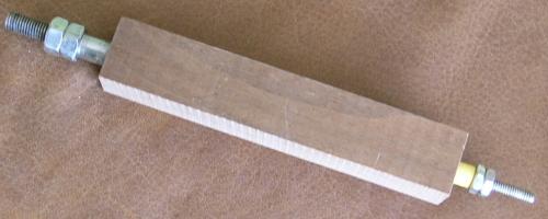

Don,
I put a slimline bushing on the mandrel at the clip end and use that a a guide for final thickness on that end. I do not turn it all the way to the bushing usually but just for relative thickness. I put the clip on a drill bit or one of the HF punches the transfer it to the pen from the clip end by just sliding it of the bit. Saves sliding it all the way from the nib.

I turn my pencils between centers with metal tooling parts that are very similar to the wooden parts I show in my article. I would be very interested in how you use a mandrel. As I sit here thinking about it I have thought of a couple of way it could be done. That sure would add stability to the barrel when it starts getting smaller in diameter. Thanks for the support. My observations are that people who use the pentel pencils really like what we do with them and those who don't use them just think they okay at best.

Well, since I spilled the beans concerning the use of a mandrel I guess I will have to divuldge one of my super secret techniques. The mandrel I use is a customized mandrel I picked at a wood craft. It has been shortened and rethreaded with a step on one end. Here is a photo with a blank mounted ready for turning. Have used this one for about 5 years and really need to make another since this one and been bent and restraightened several times
<br />
Don't tell anyone about this ok? [:D]

Chuckie,
Very clever, very clever indeed! I like it and I had not thought of that solution. Thanks for sharing and I'll not tell anyone...since the pentel pencils are so tacky, I may be the only one that reads this post.[:D][}:)] One other trade secret question. Do you use a brass tube in the larger hole...I had thought of using a tube pushed in about an inch from the top and a pin chuck that I have for slimlines. Thanks again.

Don,
No, have never used a brass tube in one of these. Your idea sounds like an interesting approach.
Chuckie
