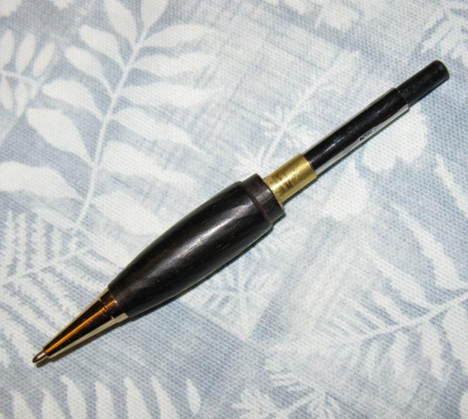

I woudl say just do the same thing except you have a turned wood bullet instead of a metal one. adjusting for the nib woudl be up to you as well. for the most part this means the lower tube is going to set deeper into the wood than his measurment. Be careful not to drill through the tip of your wood bullet though.
Here's that pic you asked for
The nib is installed in the 7 mm tube
You turn the wood to the slimline bushing and the nib fits.
