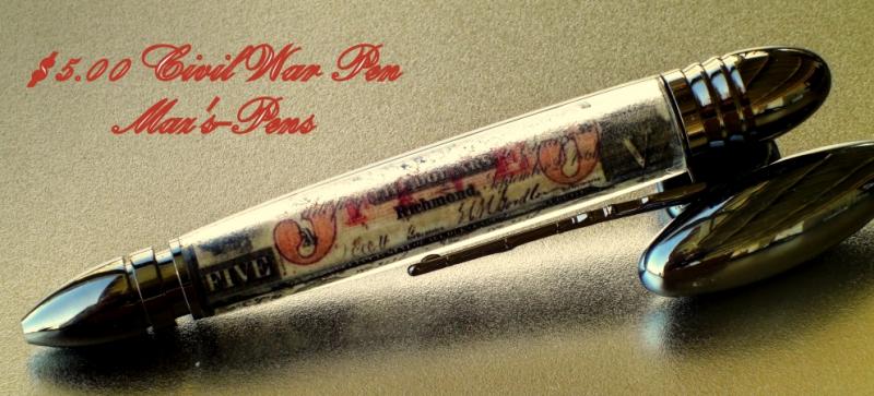

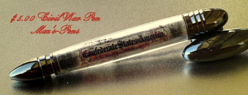

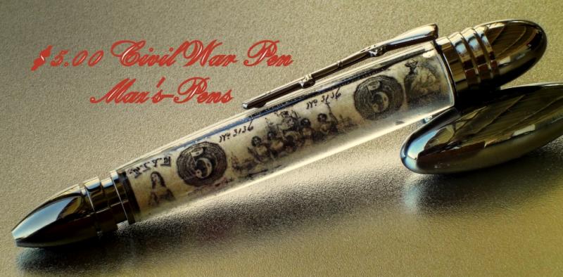

This one is for my little Brothers Birthday Today, He already has one of these in red and gray and he claims that I never give him any money. So here is a civil war pen done with a (reduced replica :wink:) "Confederate States of America" $5.00 Dollar Bill, It is cast in Alumilite and sanded to 1500 then plastix polished. It is on a black ti kit.
Any Comments Welcome, and Thanks for looking. :biggrin:

Excellent pen, color matching and photography! I love the way it looks as though it's lit from the bottom. and the Black TN is complimented by the coloring of the background and the balls (eggs, magnets, whatever they are) the pen is resting on.
That style is one of my least favorite styles, but what you have done makes the Civil War pen a real stand out. Great job on a difficult style pen to bring through. The fit and finish is spot on. Tying the Confederate currency in with that style is near perfect. Congratulations.

Great looking pen and a excellent gift Max! brother will love it,also Max that's a real nice casting job, what's your choice of glue when gluing things too the tube's.
This is the first Decal-Photo type casting that I have done. I used Avery's self adhesive shipping labels. I did some testing with how well they stuck to the tubes by leaving them on for 24 hours then trying to pull them off. They were a bear to get off. I sealed the edges with thin CA and allowed it to dry for three hours before casting. I sealed the ink with Krylon Cristal clear spray.
