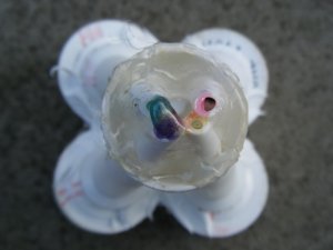

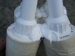

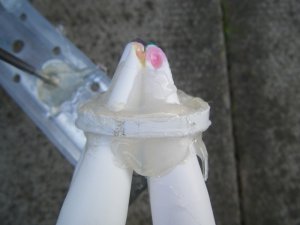

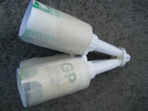

4 colour pour system (Pic Heavy)
Absolutely Bonkers and Brilliant at the same time. :biggrin:

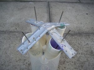

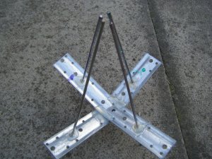

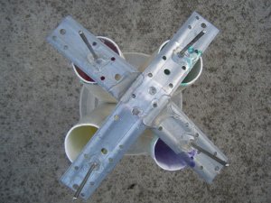

I'm guessing the rods act as plugs? Can they be operated independently to control flow?
I'm impressed....
I don't cast, so I just get to look at all the neat casts everyone else makes. In this particular case, I think you just hit the ingenious factor 9! If you need someone to test turn any of those, I'll take one (or more) for the team, so no one else has to suffer through them.....:eek:

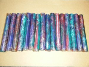

They look outstanding!

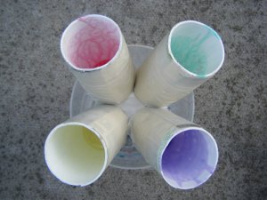

That looks promising Eric, how about cleaning it out? The blanks look great. Was there any problems with the pour? Did the 4 rods act as a plug/brake for the resin?

Hi all, thanks for the comments. The rods do act as stoppers, and I suppose they could be worked independently but that's not my aim. I forgot to mention that I put 5oz in each tube and managed to pour 17 blanks, not bad. I didn't bother to try and clean the tubes as once the resin cures it won't be a problem.

Instead of using the cartridges I just might have to use the ole Walmart version ... you know, the squeeze bottles used for ketchup and such. They are cheap and easy to get.
The rods used as 'plugs' can also be used independently and lifted one at a time - or all at once obviously.
Gluing all four tubes together is the trick I believe as that way your hands are free to do other tricks like turning the receiving vessel as it fills, etc. Just let your minds wander a bit and the end results are endless.
