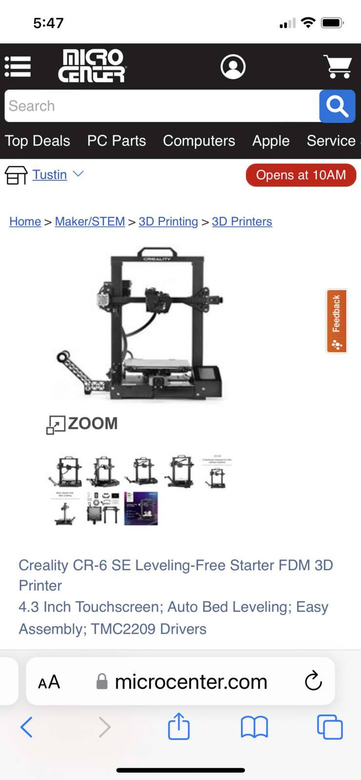

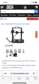

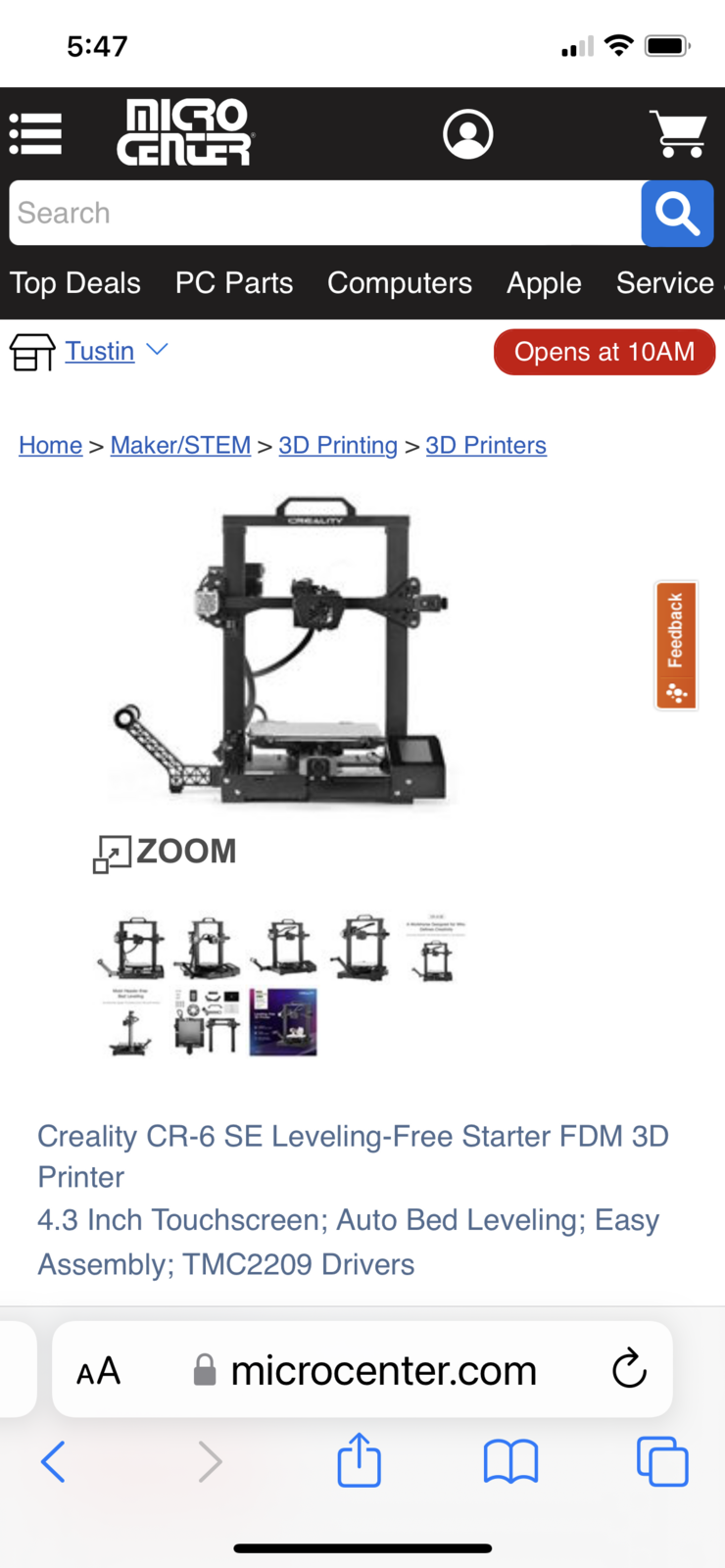

This printer caught my eye.
I was considering the CR-6 when it was being crowdfunded. I ended up going with the Ender 3 V2. There are comparison videos online which will show the differences. They are both great printers and if you go with the CR-6 I am sure you will be thrilled with it.
I now have 2 of the Ender 3 V2 printers. It has been a great printer for my hobby use. I make a lot of things for the shop and my kids make all kinds of toys, statues, and collapsible swords. I think the most significant feature you want to look for in Ender printers is the auto bed-leveling feature. It really helps get cleaner prints. Some printers do not come with auto-leveling, but you can easily add a Creality auto-leveling kit (CR Touch) for about $50. That CR-6 has auto-leveling built in. I would also replace the stock plastic extruder with a metal extruder. You can get metal parts on Amazon for under $20 and swap them out. The last inexpensive upgrade would be to change the Bowden tube to Capricorn. Capricorn tube feeds the filament much better than the stock Bowden tube. There are upgrade sets on Amazon that have Capricorn and metal replacement parts.

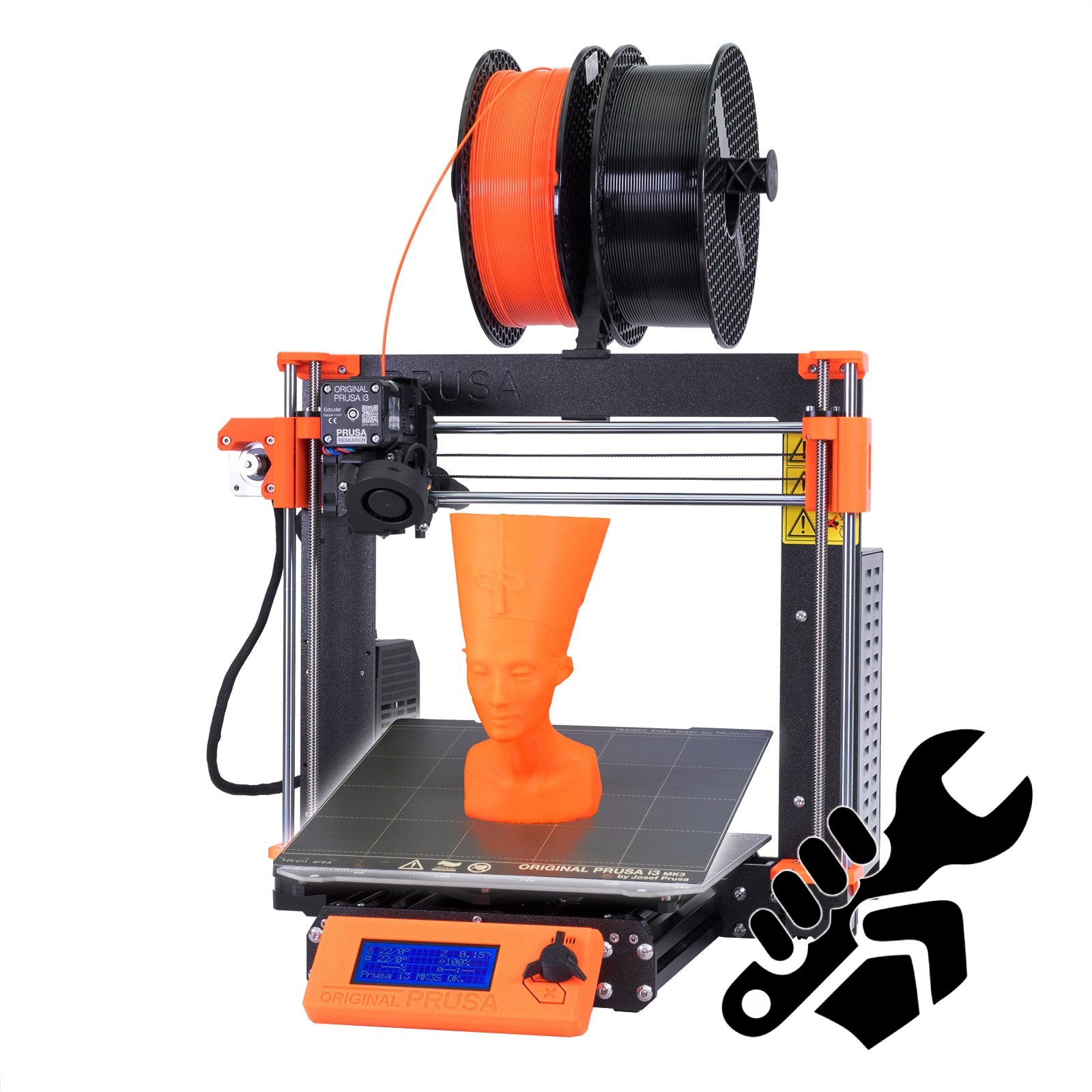

Prusa is gaining interest now, especially the completely built version. The auto leveling feature with each print seems excellent along with the roughly 10 x 10 build size.
They are great printers. Huge user community and lots of available parts and accessories. Print quality is top-notch as well.

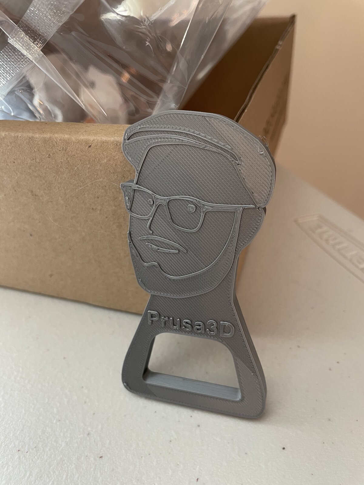

Baby steps!

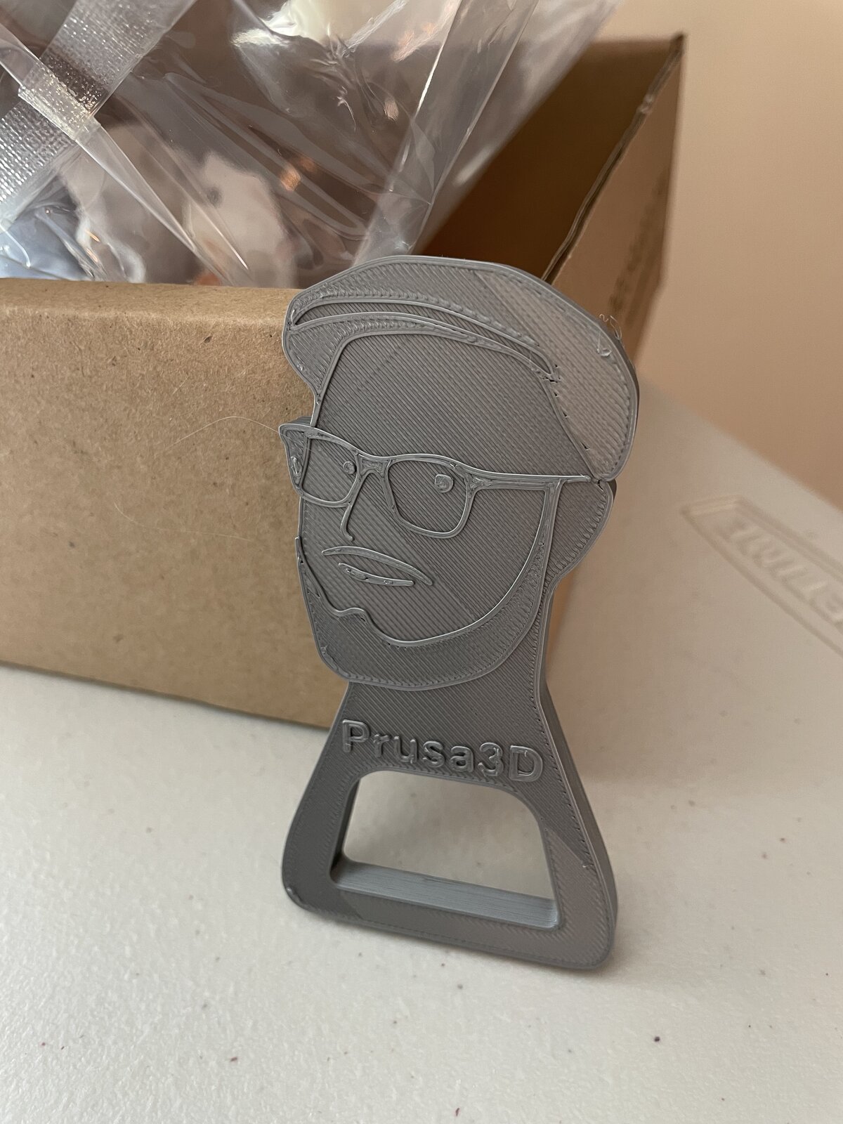

It arrived in pristine condition
I ran the calibration and alignment routines
It autolevels with every single thing you print.
I printed a Prusa bottle opener from the SD card

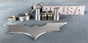

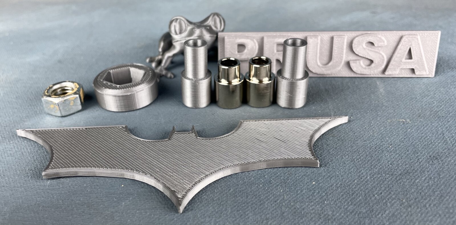

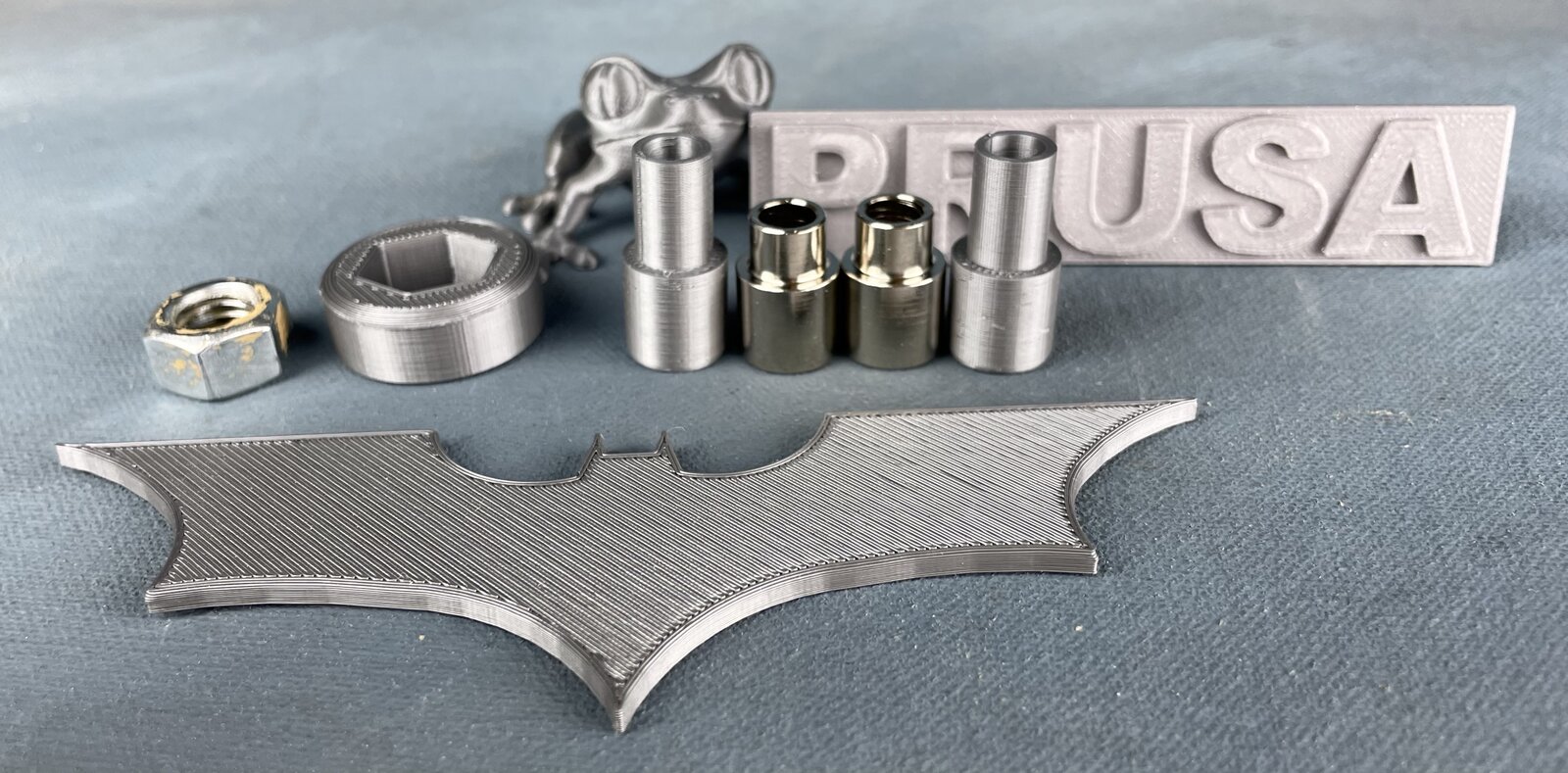

I still have some very minor fine tuning, but Tinkercad is working well as is Prusaslicer and my Prusa MK3S+ 3D printer. A learning curve was not too painful.
My goal was plastic sanding and buffing bushings and I've achieved that goal. Now my Nikitas bushings will be used just for turning and my lathe made Delrin bushings will be retired as I 3D print their replacements. Good news - lose one or damage one and 20 minutes later you have a brand new copy.
It is possible that I'll switch to another filament, but considering what these will be used for and the temps involved they should be fine.
I made the stock bushings 25.4 mm long to match the Nikitas TBC bushings instead of PSI lengths. Bushings created by me and the hex nut handle too using free Tinkercad.
