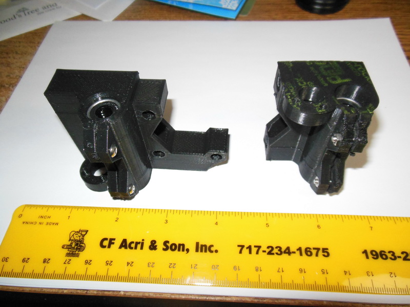

Peter, PLEASE DO NOT get a kit first time out of the gate. It is difficult enough with an already assembled printer. Do not go for cheap. I did both of these and regret it!
3D printing takes HOURS AND HOURS to produce a 6" x 4" x 4" object. Not suitable for mass production.
These two objects took 23 hours to create on my printer.
View in Gallery
For your second printer you can get a kit. You will learn a lot, and expand your vocabulary of curse words. :smile:
3D printers are not as simple as pressing the print button on a computer.
I've been playing with my kit, cheap, printer for 3 months and am just now getting it to work reliably. I need to upgrade some of the printer components. 3D printed objects usually require some clean up. Holes may not be the exact right size and may have lumps and bumps inside. You may have to drill them out as cleanup. Threads are not going to work.
I didn't mean to make this so negative, but just want you to know what you are getting into. GO FOR IT!
Things like this can be adjusted with the SeeMeCNC printers. There are some kits out there that lock out their firmware and won't allow you to adjust it. If dimensions are not correct, Hole sizes etc, then try to find out if you are able to adjust your steps per mm on your motors. Judging by your printed parts, you have a Cartesian style that probably uses threaded rods?? You may also check to see if there is a Threads per inch (or mm) setting that can be adjusted. If either, or both are off by just a bit, that can cause your dimensions to be off. Also, make sure there is no backlash in your lead screws or belts.
I agree there are some kits you want to stay away from - sounds like you found one. ;) But there are also some kits that come with everything you need and no fabricated or printed parts. and depending on how mechanically inclined one is, easy to assemble. LuzBot I believe still has one (over priced IMO) and SeeMeCNC are kits that are easy to assemble, but time consuming.
I print threads just fine. I've printed 0.25x20. Small threads like 3mm or 4-40 don't bother, just print the hole small and run the screw in. It will make it's own threads.
If you are getting clumps in your holes, then you might be over extruding. Here is a good guide to help figure out what you might change depending on your printed results.
