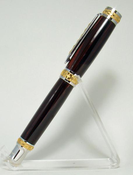

Awhile back I posted asking for suggestions on making a $500 pen for a customer. I compiled and presented the suggestions to the customer and he decided on a Jr. Emperor with black/red Ebonite and an 18K Nib. The customer stopped by the house last night to pick it up and he was thrilled with it. He said that he was somewhat envious of the person that would be receiving it (it is to be a 30 years with the company gift). My final price ($398.50) was lower than he wanted to spend, but that is how I calculate my prices. Some customers have told me I don't charge enough and maybe they are right.
I showed him some of the other pens I had for sale and he bought a Jr. Statesman FP for himself for $94.
The ebonite came from ExoticBlanks.com and the 18K nib from HeritagePens.com

Thank you for all the great comments! This is the second time I've turned Cumberland Ebonite. It's a good thing I have a poor memory or I would never have agreed to make a second pen out of the material. Getting the tiny, little, itty bitty, micro scratches out took so long that more than once I had decided to give up the project and refer the customer to one of you one this site.
After turning it to the final shape and getting it sanded, I went to micromesh, Novus scratch remover and finally the buffing wheel. Not sure if I should admit that I disassembled the pen 3 times because I wasn't happy with the shine. It looked good in the shop, but when I put it together I would notice some of those tiny scratches.
It seems that I had the best luck leaving the lathe off and using the finer micro mesh and Novus lenghtwise by hand. After assembling it the last time I was happy that I took the time to get it right. Not sure the finish is perfect, but it is about as close as it get to perfect.

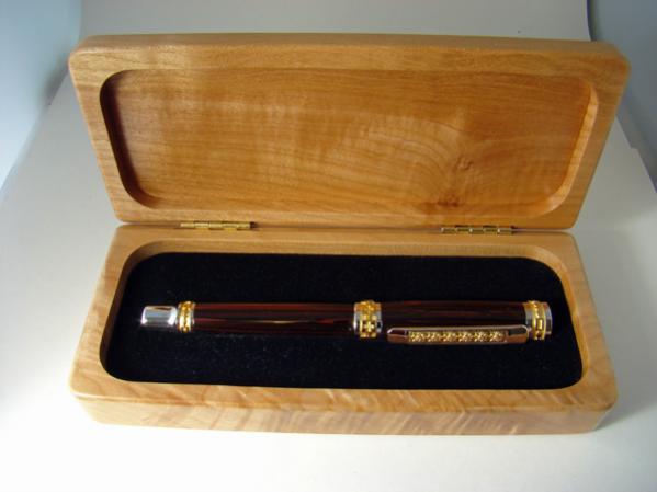

I forgot to mention that I ordered the case from kallenshaanwoods.com and he engraved the top of it thanking the person for their 30 years of service.
