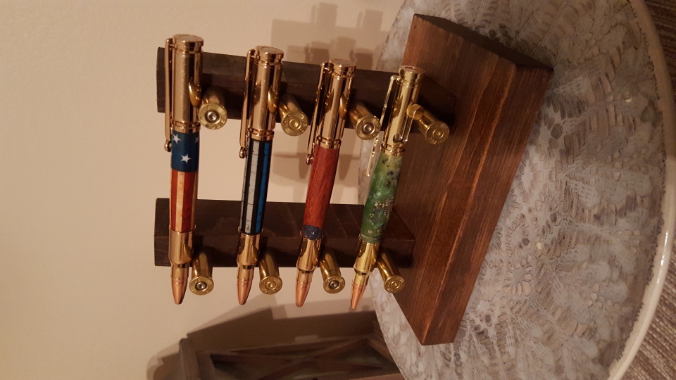

I've had a bunch of .38 special casings laying around for a while now, and had this idea for a cool display stand. Any comments or suggestions?

Joe, Cool idea. Not only for displaying your bolt actions at pen shows but also making single stands to display on desks. A lot of possibilities.
Seven
Nice. I could get a supply of cartridges at the local gun club.
Edit- You could also pop out the primer, drill the wood and run a sheet metal screw into the primer opening.
I was actually able to get a nice, tight, press fit by drilling a .375" hole since the casing was only .005" bigger.
-Joe
Good way. Again, nice display. Need to take some relevant pens to the gun club and your display will fit right in. Thanks for sharing the photo.
