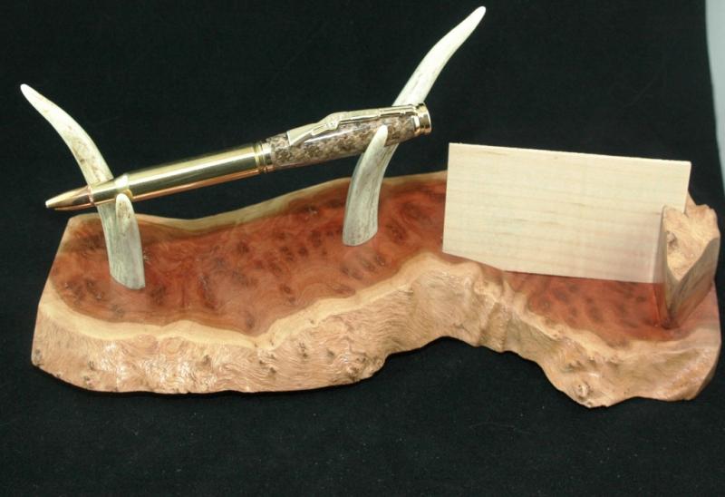

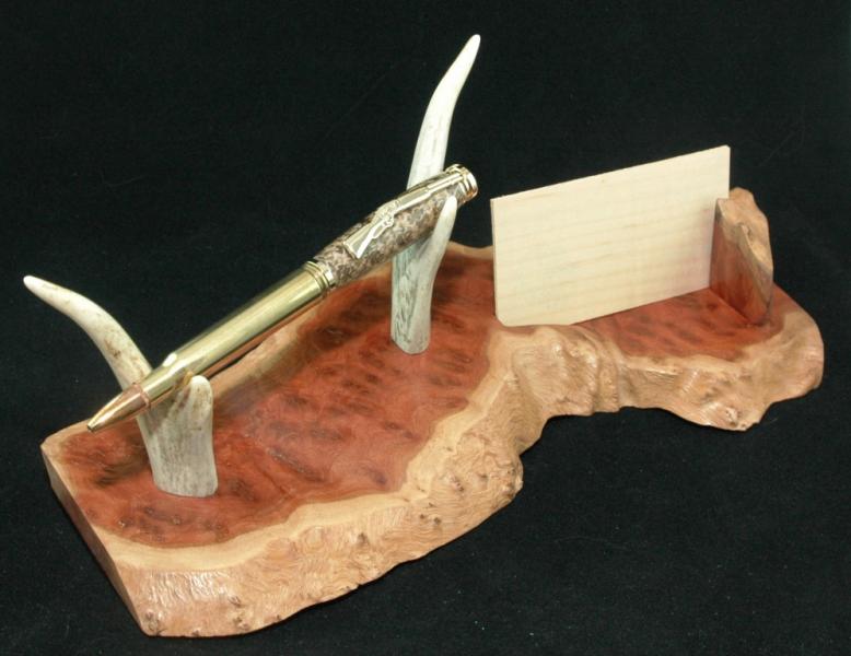

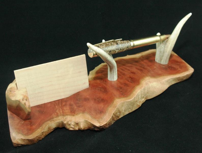

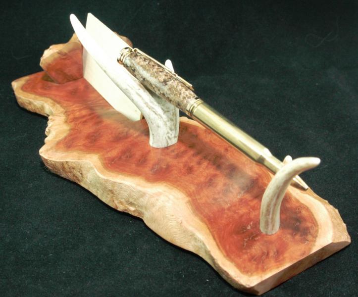

I have mentioned this project in a couple of over threads.
It is finial finished and ready to critique!
The Pen is a Sand Rattle Snake 30-6 converted Twist pen
Barrel / kit compliments of the "SNAKE KILLER" Seamus!!!
The pen is regally presented as it rest on two deer points.
The Stand is a piece of Australian Red Mallee Burl - I turned the burl like I would a winged vessel - I turned the center to be higher / thicker than the ends - This allowed me to carve into the burl to set up the Business Card Holder. The other side of the card holder is a cut off piece from the same burl.
The base / Footing is a "Floating Foot" This gives the slab the appearance of floating.
This is difficult to see from the angle of the photo againts my black photo tent back drop
The Stand is 11" in length by 4" wide
Now
BRING ON THE COMMENTS!!!
I welcome good honest critique from my fellow turners
Thanks
Kevin

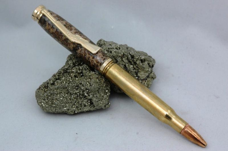

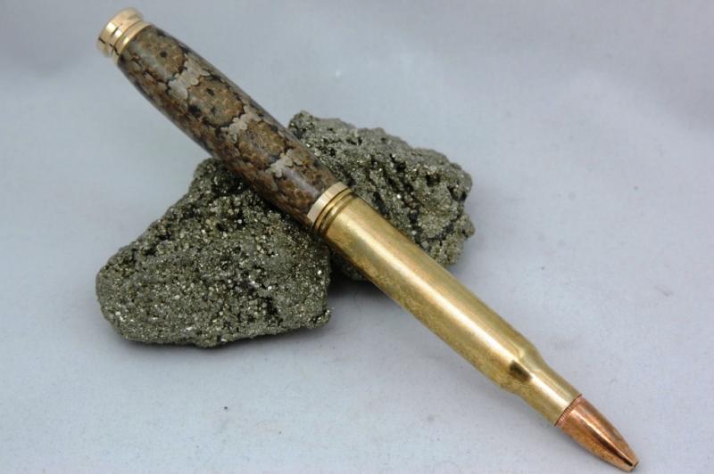

A good point was made to get a closer picture of the pen - So here it is

Love that pen nice job on it. My only suggestion would be use the other clip one like you have is barrel up and is weak and tends to bend the barrel down clips seem a lil stouter.
Glenn - Good to know - I will change that clip out - I don't want a potential new owner to have issues with it.

Kevin,
You put a lot of thought and preparation into your pen, stand and pen rest. Using also the card material, the method of supporting is quite unique and commendable. Somehow that antler rest appeals to me far more than using it in a pen the shape is delightful.
Red Mallee being one of my favourite timbers received a new treatment the way you faced it with those elements in a subdued way it emphasises the pen and card, the main purpose of a stand.
So often I wish the crippling postage rates were from here more friendly however my daughter who lives in Utah I will give a small Burl cap to take back with her to the states at the end of July then post to you so you can try using the Burl with the pimply stuff on top and if you have an interest in golf the head of a Golf Club Driver. If you pm me I will send a few pics and you can tell me what you think of this idea of mine in my attempt to share.
Kind regards Peter.
Nice job turning that snake blank, however I usually put the seam on the opposite side of the clip so the nice pattern shows on the same side as the clip. I like the stand too! Very nice use of materials!
