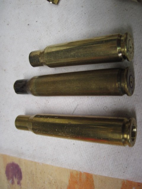

This is a blank from the funeral.The local VFW was there.It is a round they fired for his service.It was given to the young girl.You can see where the end was crimped shut.I do not reload so I do not have the stuff to make it round again.I am going to straighten it the best I can.Does anyone have a picture of a finished 30-06 pen?Thanks again.
I don't see any pic, but... Do you have a HF (or PSI) transfer punch set? If not, get one. Those steel rods are awesome for making metal round again.

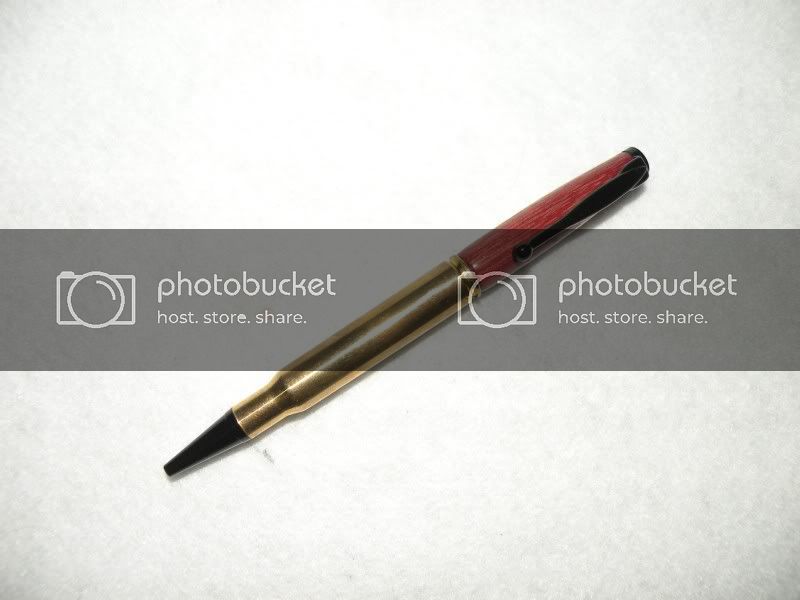

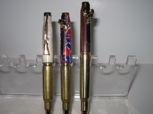

Here is a pic of my grandpa's rifle shell fired at his funeral. the nib could have stood to be a different color but i was pretty new to modifications of bullets at that time so i used some alt. ivory from exotic blanks and made my own. 7mm twist mechanism and the upper barrel is from a euro kit. I hope everyone's idea's and experience help you to create that special pen!

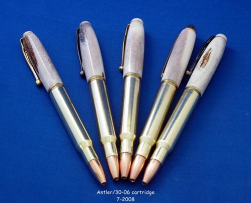

These are '06 casings:

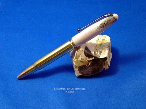

They make nice pens. Be neat if you could use a ribbon he earned in the service to use with it. Have you seen the ribbon pens in the library? Use to be a tutorial on it. Worth a look.

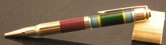

Here's an example of a cartridge pen made from a service ribbon cast in resin, a single 30-06 cartridge and a piece of purple heart wood. My taste in design has evolved somewhat since then, but this one still worked for me at the time.
Here is a picture of a pen lower barrel made from a blank fired at a military salute.
It is made from a 7.62 NATO fired blank rather than 30-06 Spg, but the two cases are very similar except for length. You can see step-by-step photos of the blank prep at 21 Gun Salute Pen Kit. If you have any questions, or need any help, feel free to send me a PM.

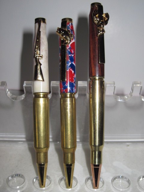

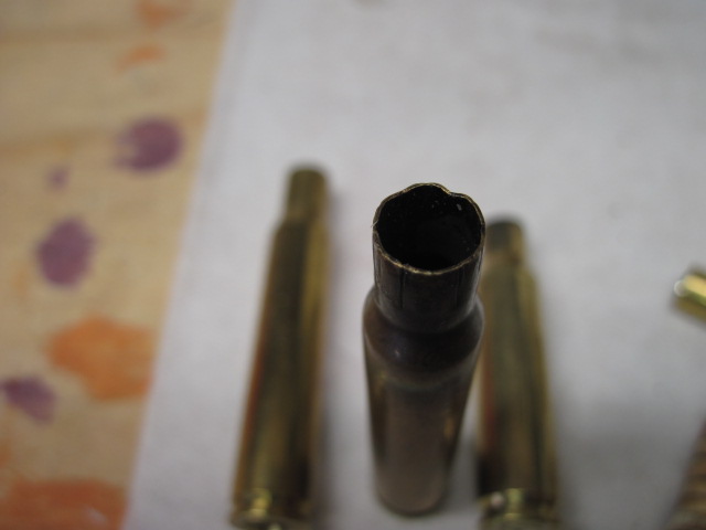

Here are 2 pics.Still not used to this camera.The one in the middle is the one from the young girl.The left is from a friend and the right is a 308.I am working on these this afternoon.Thanks.

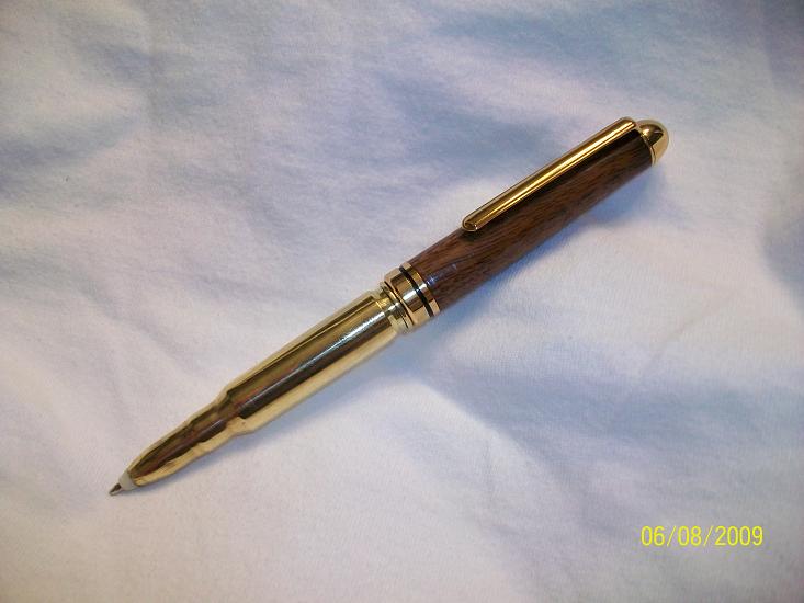

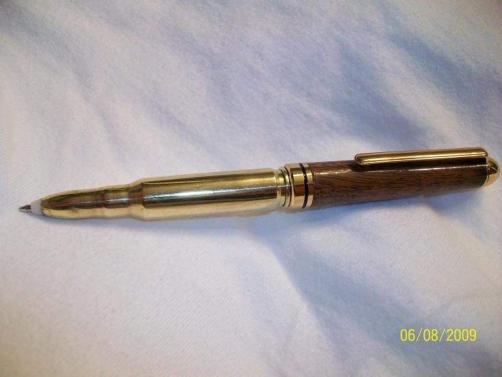

Thanks I finished the pen.If you look at post #17 it is the one with the deer head.I took the deer head off and put on a Fancy Ti Gold clip.The wood is King Wood.I used a copper nib.This is what my customer wanted for the young girl.If she changes her mind I will make another.She is a very good customer and friend.I want to keep her happy.I know she will be buying more this fall.
Nicely Done. I certainly hope she treasures it for years to come. You did a very nice job on that memorial pen.
