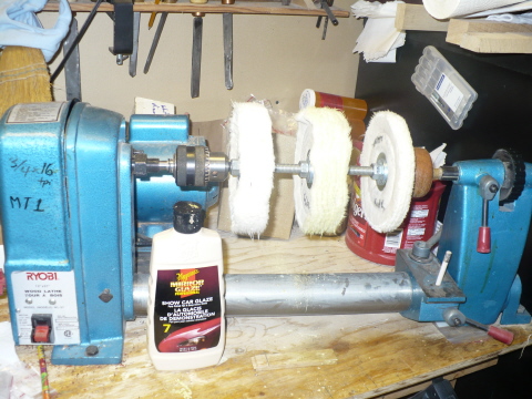

Any old lathe will likely work, I modified my original lathe, a 25 year old Ryobi tube lathe. It has MT1 ends. I made my own buffing rig with all-thread, a Jacobs chuck and a turned bearing holder for the tailstock. You can see more detail on my website:
http://www.turningshop.com/workshop-buffer.html
The MT1 in the headstock holds well with no slippage. The wood MT1 in the tailstock sometimes slips a bit, but that just warns me when the tailstock needs to be tightened again.
