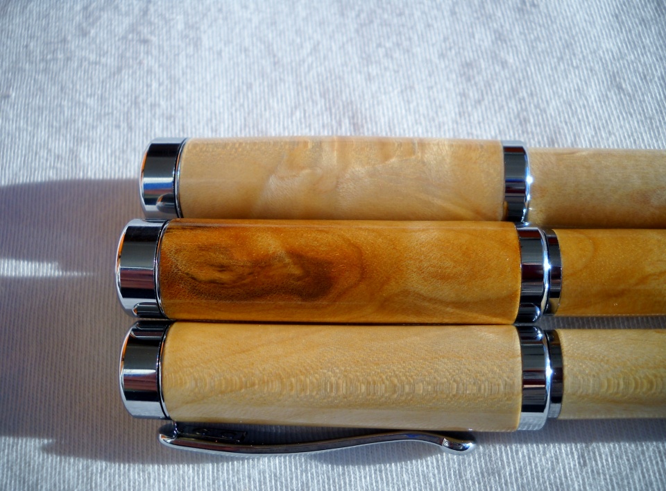

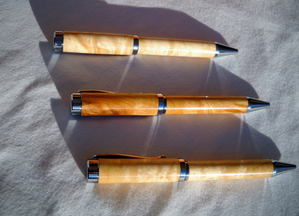

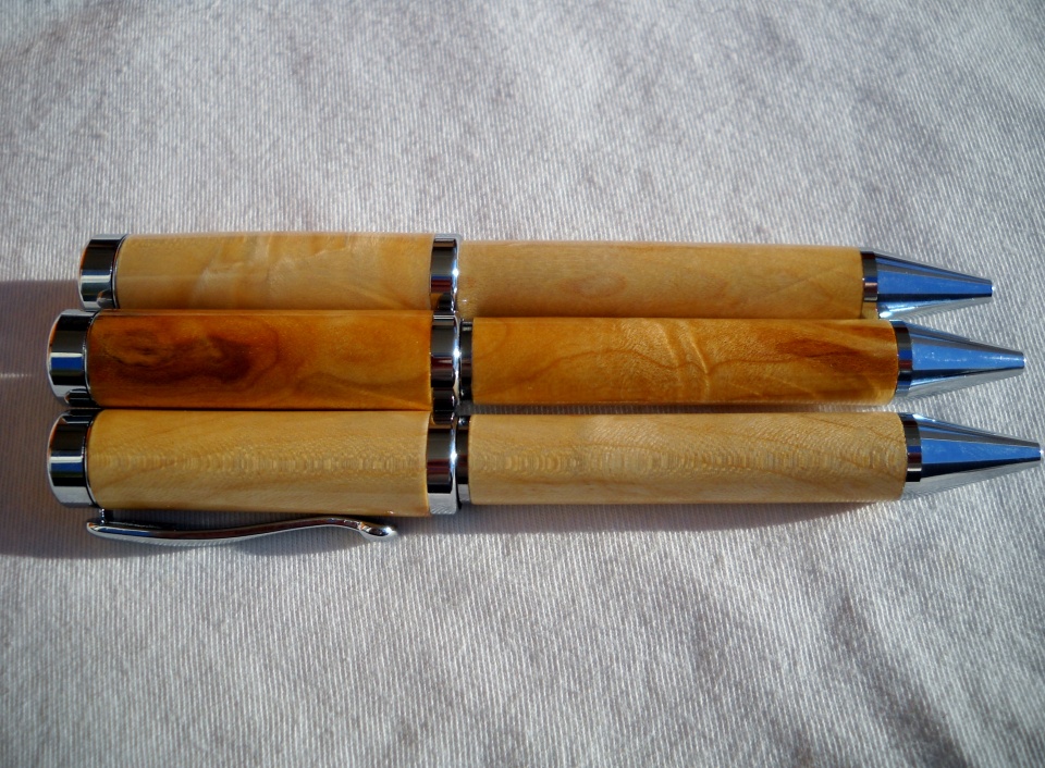

My sister-in-law asked me to make these for her boss and his brothers. The wood came from a maple tree that was special to the family. I know it is not much, but this is the largest custom order I have had.

All custom orders are very special and you should be very proud that you got one. Those pens look great. The chatoyance of that maple is very nice. You can clearly see it in all three of your images. Nice job catching that on the camera. Great job on these pens.
is it me or does the top pen have a slight bow on the cap? good job on pulling the custom order! what did you charge?

The top cap does not have a bow, but it does look like it in the pics.
