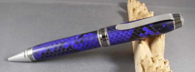

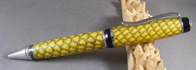

Yellow Cobra on a Chrome Cigar
Purple Python on a Platinum Two-tone Cigar (I love the look of this kit)

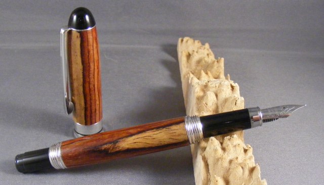

Cocobolo on a Platinum Euro Fountain Pen

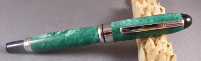

And my own Arbor Mist on a Platinum Euro Fountain Pen

The Two-Tone Platinum Cigar (which he sold out of during the group buy) comes from WoodPenPro.com, He also has them in Ti Gold/Black Chrome In stock(which I'll be doing a couple this weekend) They are really nice kits, but you do have to make a slight modification to them.
The centerband will not fit over the tranny holder on the lower barrel of the pen as shipped. You need to remove a bit of material from the inside of the centerband to accomodate this. I found it a very quick and easy mod.
I took the centerband and put the end that fits inside the upper tube in my jacobs chuck on the lathe. I then used my skew to remove about 1/32 of the material about 1/16 deep. Test fitted the other part while it's still on the lathe, and viola. It worked and she looks perfect. I'll take a picture tonight of the centerband modification.
I think the problem is that the plating on both parts are just a bit too thick, but you don't want to remove material from the tranny holder since it's more visable.

1-2-3-4, I smell some blanks from Glimmerz N More. Really dig both the snakes, think the yellow is the winner though.
They both seem to have a somewhat satin finish. I know I had problems getting a high gloss on some GNM seconds a while back. Is that what I'm seeing or is it just a prob with the photos?
Not the photos. I could get a gloss on these to save my life. These were on clearance so they may have been seconds like you got. I do have a couple blanks that were not on clearance, I'll try one of those this weekend and see if there's a difference.
After 3 tries at getting a gloss finish like on the Rattler I did, I gave up.
Not the photos.
Man, I hate it for ya. I tried and tried, never could figure it out. I've seen others turn their stuff and it look ok. Now the seconds, I don't think I had any luck with any of them. I guess there's a chance you could slather some CA on it like it were a wood pen, see if it adds some clarity, don't know if it'll help or not.
