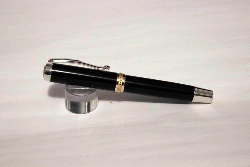

First First is my first Maj K blank on a Gunmetal Atlas FP. Tubes were not painted so that they would highlight the gold in the blank.

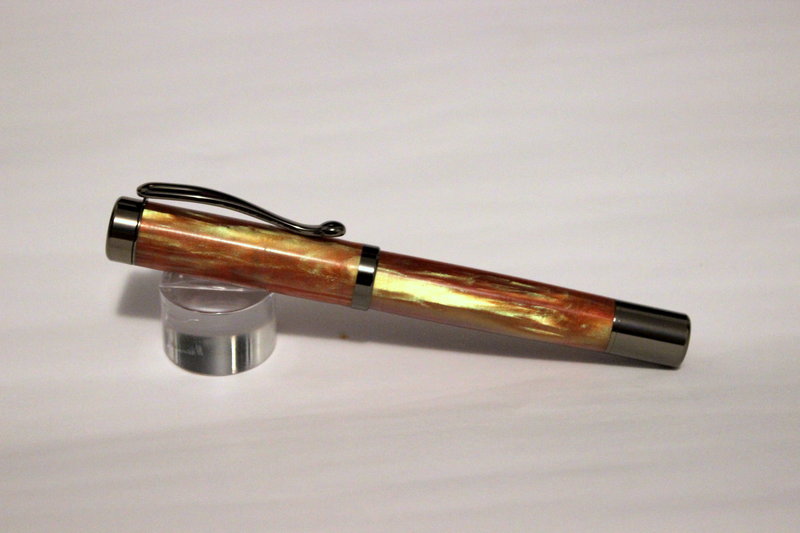

Second First is my first JR Statesman FP which is dressed in my third first, My first Ebonite blank.
C & C always welcome
Nice job on both of them Dave. I did a black Ebonite not too long ago and I know how hard it is to get a good scratch/swirl free high gloss finish on this stuff, you did a great job on that
Mike
Mike
Thanks. Every time I moved into a different light I would have to go back and polish some more. did the standard micro mesh to 12000 and then Novus heavy, novus light and novus polish. I will probably look at some of the other polishes recommended on here when I do my next ebonite.
