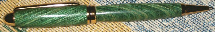

Dymondwood - now I'm 2 for 2 - I've done 2 Dymondwoods and have had to repair (reglue) the blank before completing the pen. MM to 12000 and 3 coats of PPP. I found green Cross refills on line and when it gets one it will go back to college with the youngest step daughter.

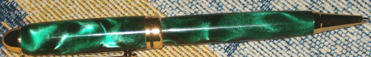

First Acrylic. "Crushed Pearl" from PSI. I'm not that happy with the job I did on it but hopefully I can learn from what I didn't do right.
(edit-->) Interesting - I took this pen to work today to show around and sold it.

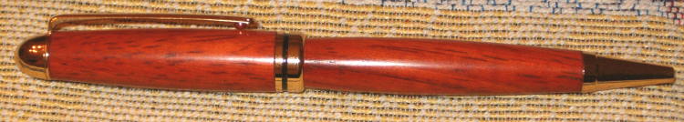

Padauk - I've had this blank since before I ever turned a pen. Sealed with sanding sealer, then filled with CA and sanding dust, then MM to 12000 and 3 coats of PPP. This will be my wifes daily writer.

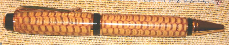

3rd CornCob pen - Iowa Cob blank. CA/BLO finish. First SOLD pen.
Originally posted by SteveRoberts
<br /> Green cross refills?
My step-daughter likes to write in green ink - that's one of the least of her quirks.[:o)] I wanted to see if I could find a refill with green ink that would fit the pen and found them on Cross' web site for $3.25 each. They charged tax, but no shipping.[:)]
