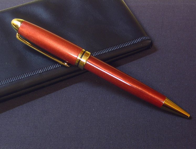

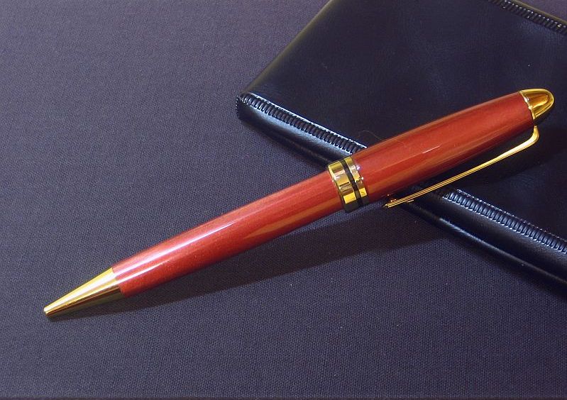

Couldn't wait for my other kits to come in, so I put this Metalic Red acrylic from Exotic Blanks on a TN Gold Euro kit. Not as crazy about the color as I was about the purple one- too monochromatic. Still it looks nice. I just realized that it's only my second Euro pen too. Did the first one years ago for my sister... This one went ok considering I haven't turned any recently...
I even got this one concentric on a mandrel!:eek: Must be my cheapo bushings on the comfort/slimlines making everything out of round.
Took me forever to turn it down though. This metalic red blank appeared to be a lot more brittle than the madreperlato purple. But still...
What's the secret of turning this stuff fast? I don't see how Ed can get any blank on and off the lathe in five minutes...

I was using the roughing gouge at first and noticed I could remove material faster by getting the point of one wing into the material. It was pretty "chippy" but worked for roughing.
So once I got it round, I switched to the 1-1/4" skew, and used the points of it. Then I used a combination of planing and shear scraping to get it to final size.
But Holy Cow it took for-eeeevvverrr....:frown:
