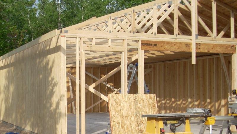

wish I were 23 and not so exhausted..but here is where I stood yesterday on the building of my 23 yr dream:highfive:

Those wall studs seem very close together. What is the spacing?
What you do it differently downunder ??? :eek: Upside down??:rolleyes: they are 2x4 on 16 centers
Firstly they are called 4x2s. You see, we believe in labelling everything correctly.:biggrin::biggrin::tongue:
Our 4x2s are spaced at 600mm centres (see, we even spell correctly :rolleyes:) That's 24 and a bit inches. In some cases the centers - oops! - are spaced at 450mm or 18 and a bit inches. We also place noggins between studs at 1200mm from the bottom plate.
It suddenly struck me after I had signed off that with all those studs and the bracing provided by the sheeting, that your shed (shed= a place for a bloke to work, daydream, potter,invent.enjoy solitude etc.) probably has t endure some substatial wind loads and down force on the roof. Am I correct?

AH HA..No wonder you were amazed at my studding..no noggins..how could I have forgotten noggins? Geez...Yes the roof must withstand high winds and very heavy snow loads..it's minimum pitch of 4/12 (foot high over ft horizontal, just incase I'm doing it backward again) :biggrin: we can get 12 ft or more of snow in winter (which is your summer) So a sturdy roof is essential...thanks for your comments & questions...:smile:

Art, get with the program! We changed to metric quite some time ago, what's all this mixing of sizes. They are 90x45, get it right please!
