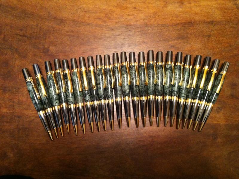

Well, I finally finished my first big pen order. I figured out how many hours I spent on these 23 pens I should have just gotten a job at the Starbucks down the way from my house... the pay on this job was the same, and I haven't counted wear and tear on my equipment and the extra electricity to run it all.
But it was a great learning experience just the same...

Well they looked liked they turned out well. What color did you paint the inside with. Did you have any problems with blow-outs air bubbles or anything like that. From what I see in the photo looks pretty good. I know it can be grueling doing the same thing over and over again. But it's a good feeling when it's done and delivered.

Bruce, I painted the gunmetal replacement tubes (looked better than their normal color) and the inside of the blanks with black, high temp primer spray paint from auto parts store. The blanks had no bubbles in them, but I did have to put two coats of medium CA glue over the finished blank to hide the edge of the paper showing through the PR.
