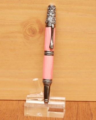

On the Victorian, only the spring and part of the cap are steel. My wife and I purchased as a possible "feminine" desk pen; but, it is pretty large in diameter and heavy. I turned this in one pink trustone, I think that it came out well also, take a look at the attached picture.

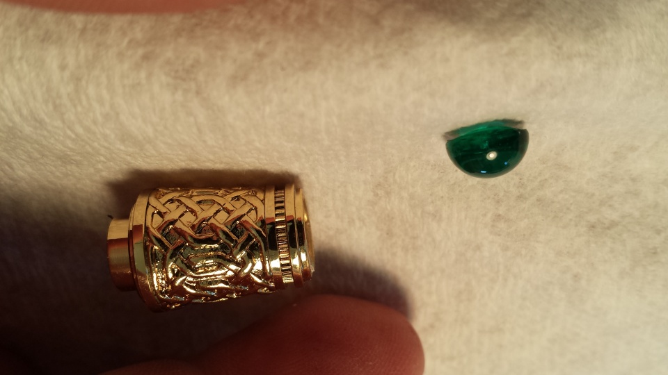

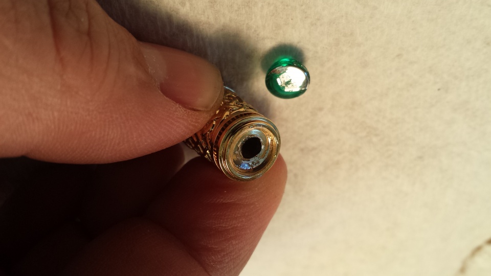

Okay. I got bored and popped off the jewel. You can absolutely make a custom finial. The metal that you see when looking into the top is simply a mirror like paint on the bottom of the piece of green plastic that is the jewel. After popping it out there is a hole there to accept a finial post.
Thank you very much. That's exactly what I wanted to see.
